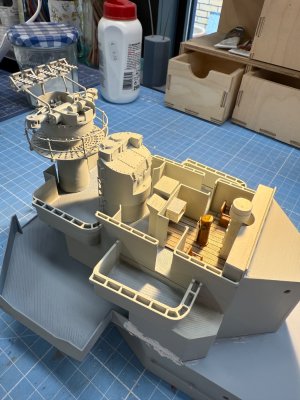

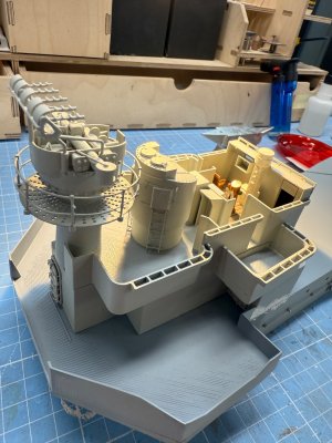

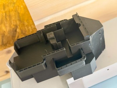

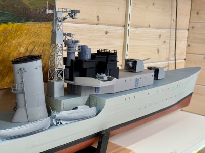

Went back to the drawing board and did all kinds of small detailing to get it 'just right'. Doors were actually worn: I did the handles on the doors and of course they should be on the 'sill'. And I found a good drawing on line and shaped the handles to look more like the real thing. And they came out tip top. I also worked on the separate deckhouses and the bridge. Thinned walls to 0.7mm (were 1.2mm) to get closer to scaled thickness. Under 0.7 things become too wonky. Little details like a door handle ca be done at 0.4 or even less, but walls etc. really need some body to survive the printing. But 0.7 translates to 49mm in real life, so that's not too far off for a steel plate.
Next job is the complete bridge, so where the damage was. I'll be back with some images, but already found all in between test prints having some fault or other. I will probably have to break her up in smaller parts.

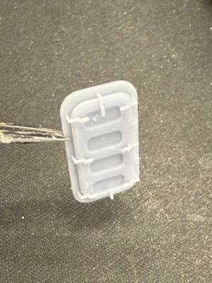

Doors in resin, deckhouse in filament. Superglue to the rescue. And the little glimmer on the door is a left over from the printer bath. Will disappear.
