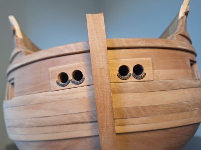

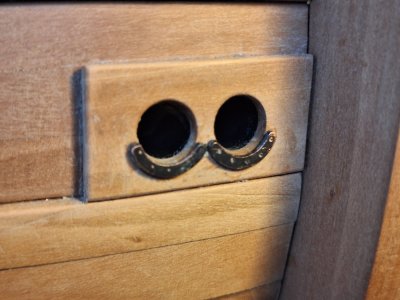

I worked on the extra timbers for the hawse holes and their partial metal reinforcement. This was my first work with metal. I used a piece of electrical wire for this (based on an idea from Stephan @Steef66 and enough wire lying around in the garage), bent it round around an 8 mm drill and flattened it. With an awl I gave it the idea that there were a number of bolts in it. Then cleaned it with acetone and then blackened it with Brass Black. Then mounted it and somewhat 'aged' it with steel wool. All in all I like the end result in any case.

Looks good
Thank you Steef and also for your great idea(s).

Your welcome, I wish you a lot of fun when starting carving. Take your time and hope to see your first attempts. And when you need help, my door is always open here in Ittervoort.

A very nice detail Herman. And it is always smart to follow Stephan - he can make a lunar orbiter from an old couch and a $3,5 Ali order...
Only if it is an old one with those steel springs, that modern Ikea stuff is only good to make an enclosure for my 3D printer. (I actual did this with a table of Ikea). But I'm still busy with my nucleair bomb that Ken suggested.
