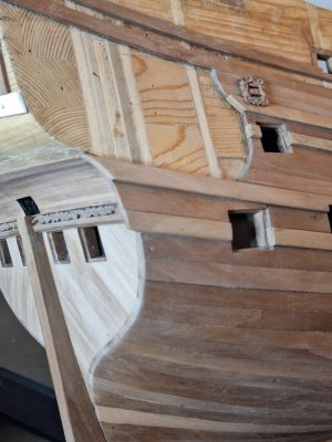

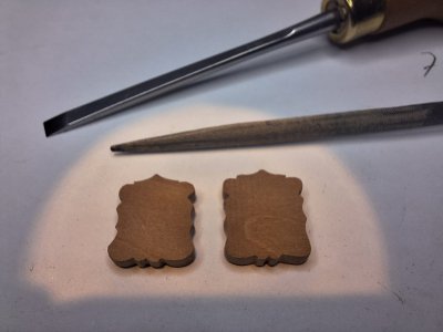

As a prelude to more difficult carving I replaced the ornament, which is used as inlay in the bow, because I found the earlier version too massive. And now was the right moment to correct that, before all the bow parts are joined together.
First of all a piece of wood was made to fit the housing; then the shape to be cut out was marked, holes drilled and the carving was made. I used both gouges, files, drills and my new nail drill.

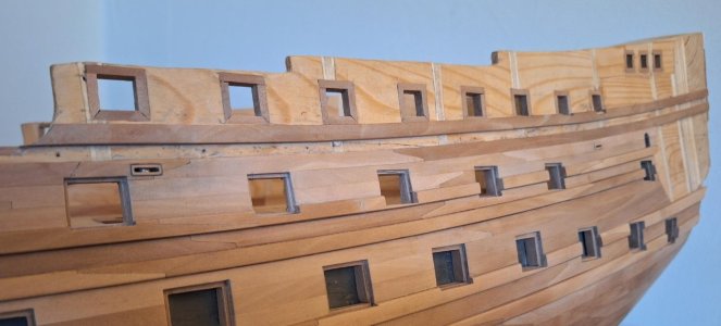

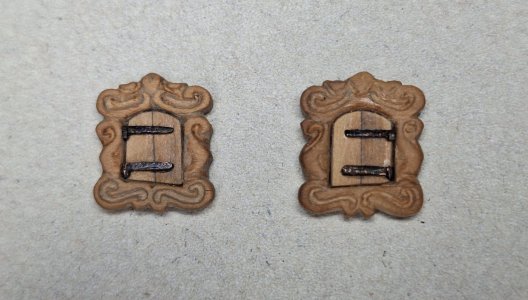

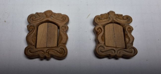

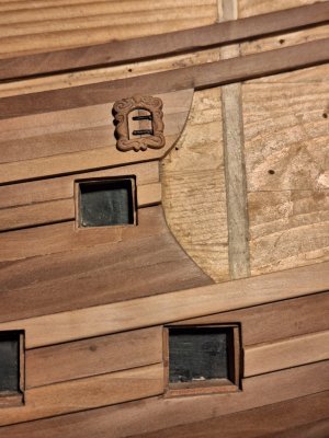

Over the last week I have made the decorated ventilation ports.
First cut out the contours, then drilled a hole and filed it to the correct shape. The ports themselves are made up of 2 slats. The hinges filed out of a piece copper wire and blackened.
They look huge, but are rather small. I have placed them on the model to give an impression of the actual size.

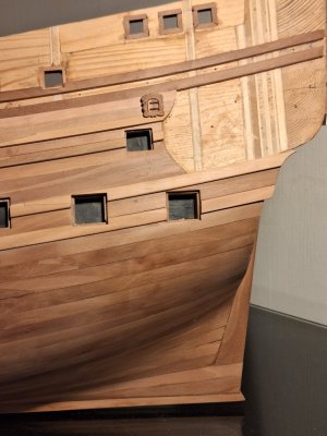

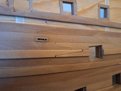

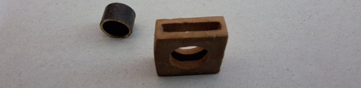

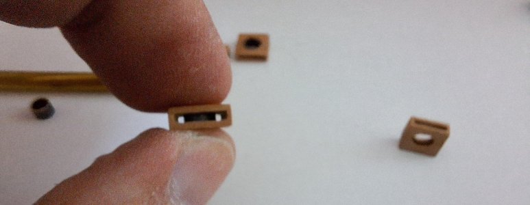

Small update .. the pulleys as integrated in the hull have been made and installed.
I first milled 4 slots into a piece of wood, then reduced the wood to 4 pieces of the appropriate measurements to fit into the hull. A hole was drilled into the wood to fit the 'pulley' in it. I don't have a lathe so I just made the pulleys themselves from a brass tube and didn't profile them. After having carefully made holes in the hull installed them in the ship. They are fine and give a good idea of how it must have looked in my opinion.
View attachment 512195View attachment 512192
View attachment 512200View attachment 512193

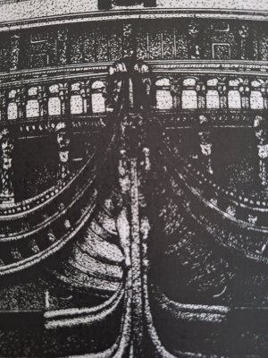

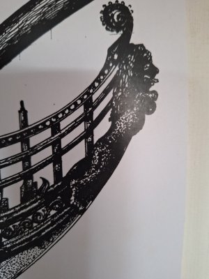

The drawings of Otte Blom do not provide a clear picture of the figurehead:

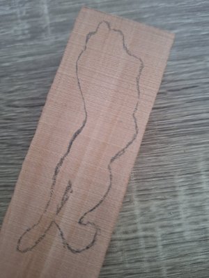

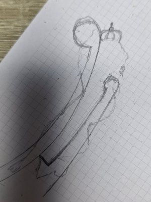

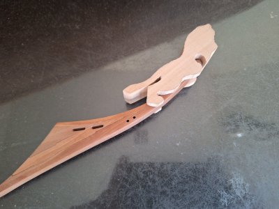

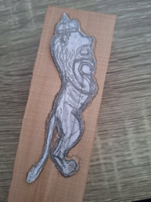

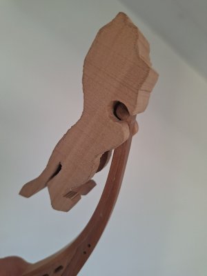

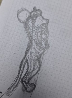

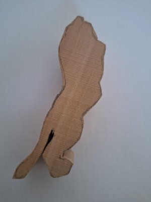

So I made, based on this drawing, my own sketch for the figurehead. I first marked out the contours of the bow sections, which have already been made since the figurehead will have to fit between them. Then I drew my rough idea of the figurehead, copied it to a piece of wood and and I used the bandsaw to cut out the outlines.
20250408_201204_resized.jpg 20250408_203819_resized.jpg 20250409_184311_resized.jpg20250409_184321_resized.jpg20250409_185149_resized.jpg

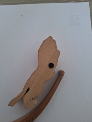

As the lion figurehead will hold on to the curl of the bow section I drilled a hole and made a slot in its belly so that it would fit over this bow section.
20250409_190948_resized.jpg 20250412_101644_resized.jpg20250412_101448_resized.jpg

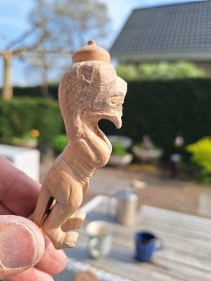

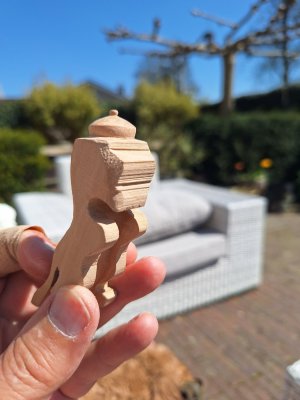

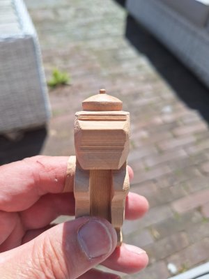

On a sunny day I took my work outside and started the carving of the figurehead.
20250412_135821_resized.jpg 20250412_135846_resized.jpg 20250413_161440_resized.jpg
My first idea was to make the crown and lion out of 1 piece of wood, but as I was not satisfied with this "hat" I abandoned that idea and started a separate crown.
As it was my first try for a figurehead I was bound to make mistakes and I did. I slipped and damaged the nose of the lion.
I started considering this figurehead as a test piece but worked further on it as I was far from sure that I would be able to make a credible lion. That is the reason I stopped making interim photos of the further process.
