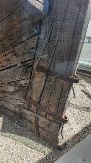

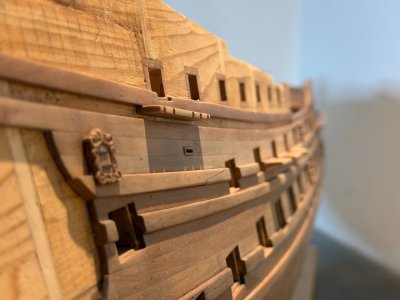

Furthermore something I wanted to add were the depth marks.
I learned those marks were applied on the bow on the starboard side (on the stern on the port side) in the form of Roman numerals that were tilted to form a clear line from which the draft could be read.
This turned the x into a +, the L into more of a tilted V, and the I's were replaced by a dot.
I used a sharpened mini screwdriver.

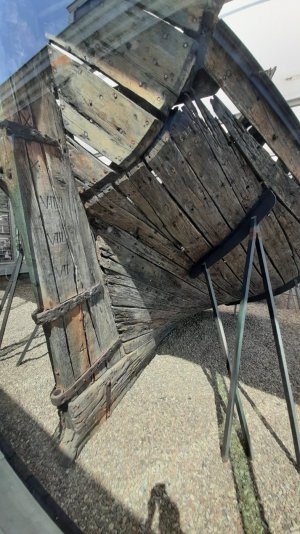

Hi Herman, very clever way of creating these with a perfect result.
See below actual marking on the wreck of Samuel, crosses and dots on the PS side and Roman numerals on the SB side.

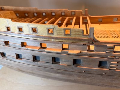

This time a somewhat longer post regarding the channels (/shrouds).

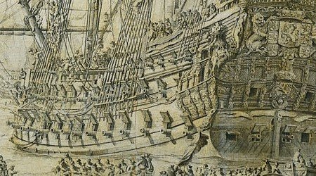

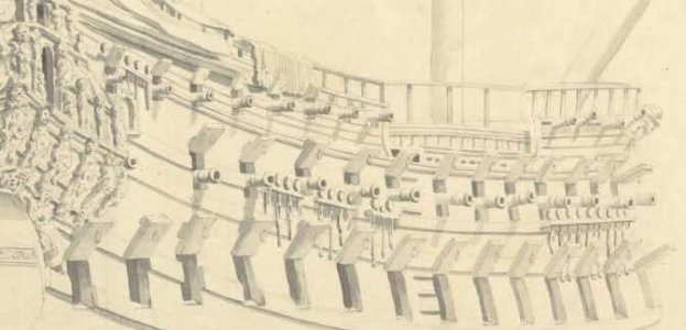

Grateful as we are for the contemporary Willem van de Velde's drawings, I must note that some differences can be discovered between the various pen drawings he made of De 7 Provinciën. The number of channels and shrouds per mast and the distribution of the shrouds per channel are not equal on those drawings.
The first drawing depicting the War Council on board De 7 Provinciën I count:
- foremast: probably 1 channel / 9 shrouds, hard to see but I think 2 + 3 + 3 + 1 shroud (counting from stem to stern, interrupted by the gun ports)
- main mast: 3 channels / 10 shrouds, 4 + 4 + 2
- mizzen mast: 1 channel / 5 shrouds (channel above the last gunport?)
The second drawing depicting the De 7 Provinciën (stern view) I count:
- foremast: 1 channel / 9 large deadeyes (/shrouds), distribution of the deadeyes hard to see but the channel seems to end behind the gunport
- main mast: 3 channels / probably 10 large deadeyes (and 1 smaller one) shrouds, 2 + 4 + 4
- mizzen mast: 1 channel / probably 5 deadeyes (one behind the opened gunlid) (channel above the last gunport?)

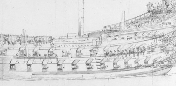

The third drawing depicting the De 7 Provinciën (front/side view) I count:
- foremast: 1 channel / 8 deadeyes (/shrouds), distribution of the deadeyes 1 + 3 + 3 +1 (the last deadeye behind the gunport)
- main mast: 4 channels / 9 deadeyes 3 + 3 + 2 + 1
- mizzen mast: 1 channel ? / 5 maybe even 6 deadeyes (counting the chain plates) 2 + 3 ? (channel below the last gunport)

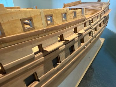

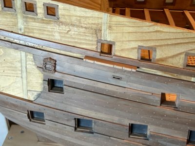

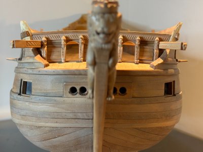

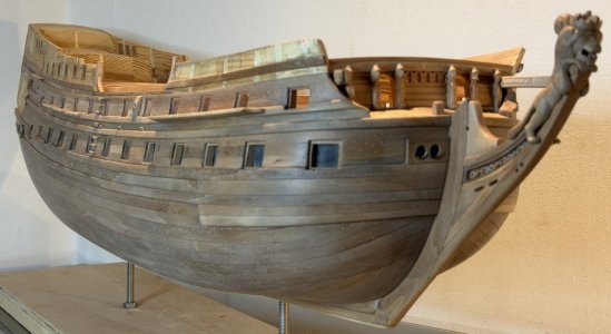

I have decided to make 1 channel for the foremast, with 9 deadeyes/shrouds to be distributed 2 + 3 + 3 + 1. With this distribution there is also enough room for the four guns on the upper deck without being hindered by the shrouds:
and 3 channels for the mainmast, distribution 2 + 4 + 4 (also in accordance with the drawings of Otte Blom, despite keeping the upper gunports free will be a challenge):

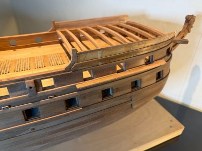

and 1 channel for the mizzen mast, distribution 3 + 2:
Front view, now with 'wings'
In the drawings from vd Velde you can’t see the difference between shroud or staytackle (zijtakels). Those cables have the same thickness and don't see the upper dead eye eigther. I would follow Blom. Because nobody knows exact how many shrouds where installed. There is no evidence and that’s why you can’t do it wrong. I love Dutch ships and their rigging. But your approch by looking in vd Velde drawings for the rigging is the best way to find out.
Rule: For a 100 feet length 6 deadeyes and for every 15 or 16 feet more 1 deadeye extra.
I wasn't familiar with this rule, AB. Is this a rule from Yk or Witsen? Or is it based on existing drawings and models? It's correct for the Hohenzollern model, but not for the Prins Willem. That ship is 181 feet long and should therefore have 11 to 12 dead eyes.
