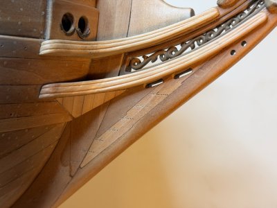

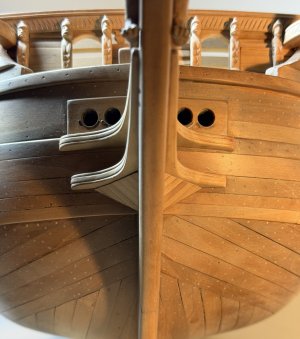

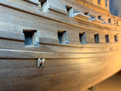

All the loose parts of the bow are assembled and mounted on the ship. Now it was also possible to make and assemble the false keel.

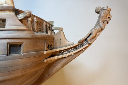

And a picture including the foremast and bowsprit.
Beautiful Work Herman. nothing short of spectacular. After looking at all these details on you model i cant believe they build it like this just to get it all destroyed by cannonballs....lol.....its a crime
Thank you Sid for your kind words and visiting my build log.
Also hard to believe building the original took only about 8 months. She must have endured a lot of cannonballs in her almost 30 year career but always patched up and in the end sold to be dismantled.
Herman what wood type did you use for the planking? i really like the colour and tone it presents, not too light making it somewhat toyish and not too dark where details are lost. just a perfect balance
Witaj
Dziób wygląda Hermanie super wszystko wspaniale dopasowałeś podziwiam .Czym Hermanie pokrywasz drzewo czy to jest wosk? Pozdrawiam Mirek
Thank you Mirek. The wood has not yet been treated at all. Only sanded and polished with steel wool.
I plan to paint the 2 lower wales and after that everything will be treated with shellac. When further details, like bolts, are installed maybe further treatment with bitumen/wax.
I haven't worked on the model for a few weeks and we are now on vacation. Ideal for the latest added wooden cheeks and channels to naturally age, and get a richer/darker color to match the hull. Maybe that's the reason I go slow ROTF .
Thank you Sid. With the exception of the deck planking (maple) everything is made from pear.
