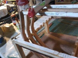

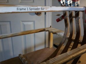

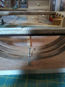

Here are some progress pictures, not to happy with some aspects, mainly the lower deck clamp it falls in the jig line,,,I have checked the location on the plans numerous times and they are right on, the mesurments on the jig are corect also,,,,I can fix the clamp when I remove the jig as long as they fall in a straight line, also frame No.3 and NO.2 the spacing does not look right,,,but again I can et the corect spacing WHEN I INSTALL THE DECK CLAMPS, want to install some more frames to see how they line up, as always critisims and coments are WELCOME, as you notice I installed the jig top with dowels so I can readly take it off to check items that is working out OK20180510_080311[3056].jpg20180510_080426[3055].jpg20180510_081308[3054].jpg20180510_081523[3053].jpg20180510_081635[3052].jpg20180510_080311[3056].jpg20180510_080426[3055].jpg20180510_081308[3054].jpg20180510_081523[3053].jpg20180510_081635[3052].jpg20180510_080311[3056].jpg20180510_080426[3055].jpg20180510_081308[3054].jpg20180510_081523[3053].jpg20180510_081635[3052].jpg20180510_080311[3056].jpg20180510_080426[3055].jpg20180510_081308[3054].jpg20180510_080311[3056].jpg20180510_080426[3055].jpg20180510_080311[3056].jpg20180510_080426[3055].jpg20180510_081308[3054].jpg20180510_081523[3053].jpg20180510_081635[3052].jpg
Looks good, you are making progress.
Mike

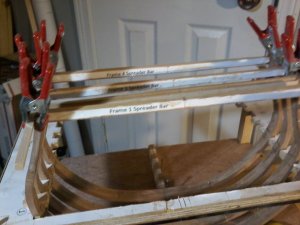

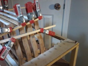

progress pictures, first four frames dry fitted, seems like it is OK, if anyone sees something wrong please let me know,,,,have a little sanding to do on the top building jig notches horizontally so deck clamp fits,and there maybe a problem with frames No.1 and 4 as when i seat them in the keel one or the other pops up will have to use CA on them, witch i dislike to use
20180523_223913[3128].jpg20180523_223641[3129].jpg20180523_223641[3129].jpg20180523_224123[3127].jpg20180523_224210[3126].jpg
Hi Don,
The notches in the top are too tight, that is causing your problem they should all be a loose fit not too loose but easy to remove. You are making good progress.
Mike

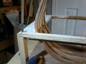

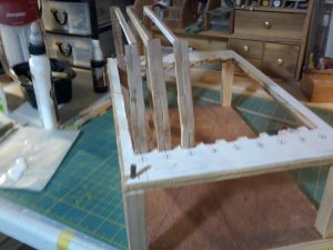

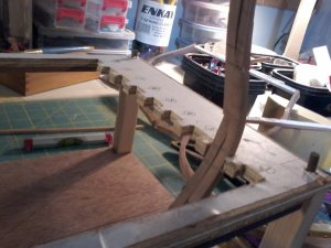

Hi Mike41, Hope I am listing this in the right place, I am having a big problem with my frames especially FRAME No 5 and No.6, will have tore-do frame No. 5 completly, frame No. 6 I have a couple of problems hope I do not need to re-make that one too, will show what is hapening with pictures in my Blanford one side of the lower deck beam is way out, it lines up perfectly on the plans but when i put it in the jig for dry fitting one side sits right on byt the other is way, way off do not know what happened other problems also will show them latter today, time to make corections at this point, any help will be greatly appreciated. THANKS Don
Hi Don,
The deck clamps are not square and level with the keel, remove the one that is way off, measure from the base of the jig to the bottom of the clamp that is right on and mark that point on the opposite side of the frame. Check with your level the base and the two points for the clamp, repeat this process for frames 1 & 9. When the deck clamps are corrected the deck beams will line up in place.
Mike
Hi Mike, Sorry I did not get back to you sooner as you well know hit some KANSAS weather the other night, power out for 11 hours and a flood in my liveingroom but all finally taken care of,,,Mike I found my answer like the old saying goes check the plans, as many times as needed finally found my mistake when I pinned the frame to the plans the bottom dropped and tilted, did not recheck it at the time of marking. put it in correct location and it was OK, valuable lesson learned, but your information is invaluable for further checking. THANKS LOADS Don
