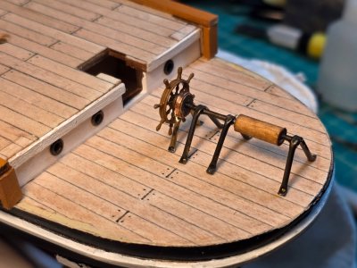

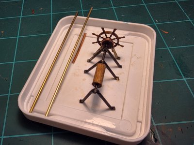

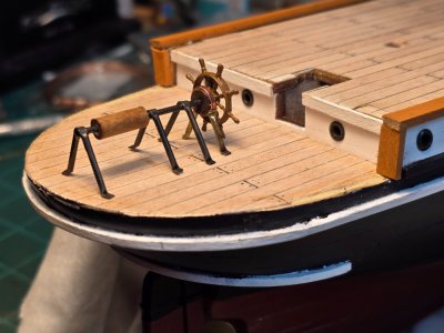

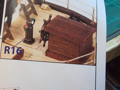

On my free time, since my last posting, I was able to built the rudder steering system similar to the original. The kit calls to built a kind off shed covering all this, a non-existent situation.
So I tried to my best to built the original steering system. It isn't finished yet. Waiting for a 1mm chain from Amazon.

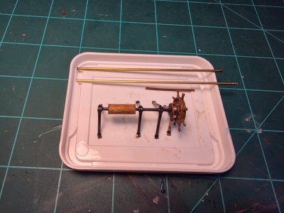

I used 1.5 mm brass tube for the legs, 1.5 mm brass rod for the wheel axis an a 1.5 mm flat copper wire for the round section after the wheel. All can be seen on the images.

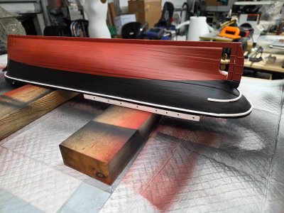

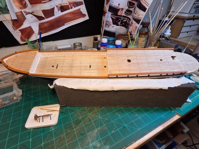

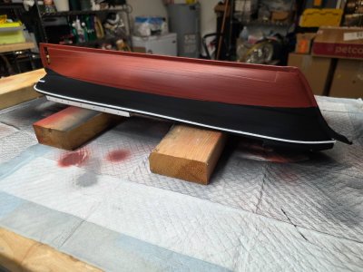

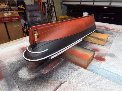

Moreover, I added 2 images showing the ship building status.
This is what the kit comes with to be built:

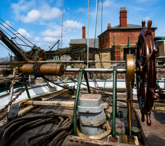

This is an original image of the Endurance and you can see that the shed doesn't exist.
This is the original rudder steering system
So far... this is what I have done

Interesting. The Photos & Model shipyards model show the the forward deadeyes on a sideboard and the more realistic steering mechanism than the current Occre model
As i told you before, that i wasn't sure what i will do, well, on my previous posting is your answer concerning the steering system. Still a lot to be done.
Best
 Daniel
Just a question - I note you said you would glue the rudder. Does this mean your steering mechanism is a static part of the model. I say this because - if it works, it is the best steering build I have seen and certainly puts mine to shame
Yes, this kit needs several modifications to make the rudder workable and I decided not to go that route. Rudder is already glued and the steering system will be static too.
I have seen yours steering system and is fine. My built was very easy, just using what I showed in the image, using stuff that I had around. For the legs I flattened the tips of the 1.5mm brass tube, then flattened the middle and bend it. And the round part after the wheel is a piece of wood with flat 1.5 mm copper wire glued around it.
