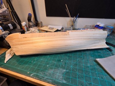

Guys.... let chat about the ENDURANCE hull.
Here is an interesting inage of the ENDURANCE hull.
Posted and discussed here:
Thread 'Endurance hull work' https://shipsofscale.com/sosforums/threads/endurance-hull-work.16692/
Do you think I can try to replicate that hull building ?
The hull will be painted all black. So details (mistakes on planking) will be hidden using putty and sanding. Being said this, I can try to add another layer of planks and copper in the keel
Am I wrong ?

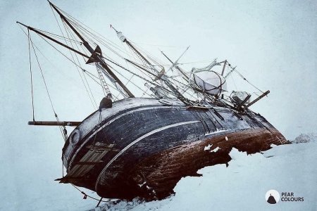

From GOOGLE
During Sir Ernest Shackleton's 1914–1917 Imperial Trans-Antarctic Expedition, the Endurance had an all-black hull above the waterline, which was a change from its original white and gilt color scheme. The ship was painted black to increase visibility against the white ice. The hull below the waterline was likely a reddish-brown or red ochre antifouling paint.
Model Ship WorldModel Ship World +3
Key details regarding the Endurance hull color:
  • Original Color: When named Polaris, the ship was white with gilt scrollwork.
  • Expedition Color: It was repainted all-black for the 1914 expedition to ensure it could be seen easily against ice.
  • Lower Hull: The bottom was painted with a reddish anti-fouling paint.
  • Evidence: Frank Hurley’s color photos (using the PAGET process) and recent 2022 footage of the wreck suggest an all-black hull with a darker or brownish-red bottom, notes of the Falklands Maritime Heritage Trust.

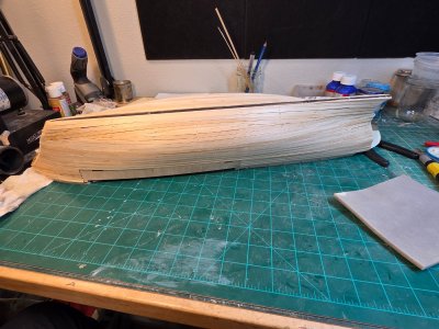

IMG_20260318_153557.jpgExacty. I think it also enhances the look of the model. There are also many excellent photographs that can be used to improve the accuracy of this kit.

View attachment 591778Exacty. I think it also enhances the look of the model. There are also many excellent photographs that can be used to improve the accuracy of this kit.

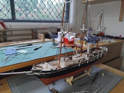

I have enjoyed researching photos of the ship to make the Endurance more accurate. If you view my Endurance build log you can see changes I have made including the red hull below the waterline.
tip: I built the Endurance, and used blackboard (school) paint for the hull. It is.. well.. eh.. black, but also extremely dull, which hides imperfections in the planking quite nicely, while keeping the individual strakes visible. Good luck with the build, it is a beautiful ship..and what a story!View attachment 591507
Model looking nice !! Thank you for posting the image. The paint i ordered is black matte.
Yesterday, searching around SOS, I found your build log. I will post the link here for me to find it easy. It has many interesting changes that I will try to replicate. I was doing the same as you, going around images, but now you saved me tons of time, as you already identified numerous changes that can be done to improve the kit or, in other words, to make it more like the real Endurance.

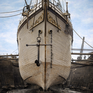

A nice image, courtesy of stephensandkenau.com, of the reinforced bow and the 2 color hull. I posted the website from where it comes below the image.
@Jimsky . , if this is inappropriate, let me know and, you can or myself, delete this posting. Thank you !
My friend Mike sent me the black and white Endurance image at the Drydock enhanced by AI for color and details.
Looks like the hull hasn't been painted yet. It is very clear now the 2 planks layers. The original of the ship and the ironwood planks as a reinforcement for the ice. Also is clear a fancy iron reinforcement at the bow keel and how it is cover by steel plates when the ironwood planking start..

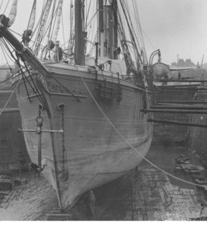

Moreover guys. I sent Mike this other B&W image
Screenshot_20260408_150619_Gallery.jpgAnd he processed it with AI for color and details enhancements.
Looks like the ENDURANCE is being painted. But details of the lower hull section with double planking are now masked by the "paint".
And the STEEL BOW REINFORCEMENT isn't fancy. It was the "chain" in front of it. :-)

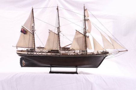

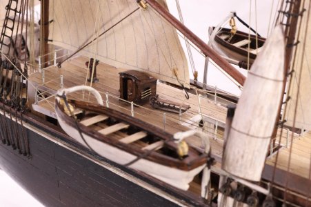

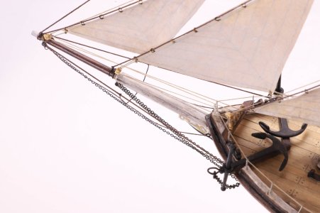

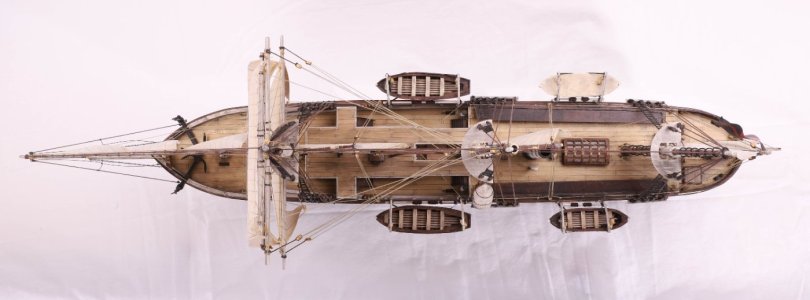

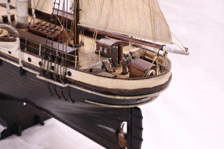

Along with the rigging you may wish to be a bit more accurate to the ships build. After looking at photos, I made quite a few alterations to mine.
Most notable is the metal supports for the lifeboats towards the bow. I heated the metal and carefully bent them the other way so I could mount them on the inside like the actual ship has. I included some photos to give you a visual guide if you want to dive deeper.
Good luck on your build! I hope you enjoy it as much as I did :)

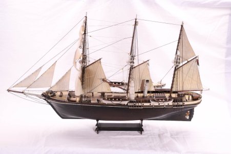

Well Daniel... the ship is called The Endurance for a reasonROTF
Thank you very much Joe for posting the images !!! I can see you did a few changes to the kit. They all looks great. That rigging work looks also fantastic. For sure i will be paying attention to your changes as well as the ones others modelers did.
Thanks again !

Adding the link to all your pictures:
Thread 'Photos of the Finished Endurance Build' https://shipsofscale.com/sosforums/threads/photos-of-the-finished-endurance-build.15670/

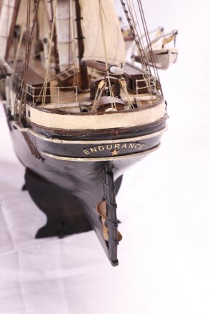

Interesting. The Photos & Model shipyards model show the the forward deadeyes on a sideboard and the more realistic steering mechanism than the current Occre model

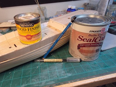

Good morning!!!

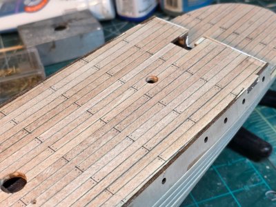

Here is where I am. Haven't done any different from instructions. First image shows what I used as of today. Pencil for deck planks caulking, ink marker for nails and end of deck planks. Sanding Sealer and then cherry stain for deck color.
Ink marker used after the sealer was applied.
Now a lot of sanding !!!
Cheers
Daniel
