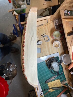

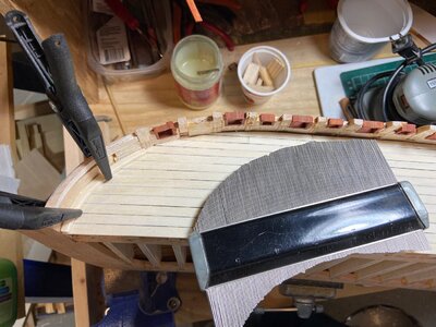

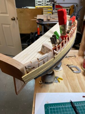

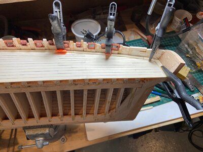

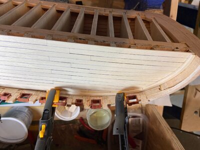

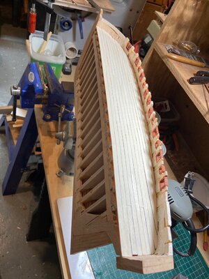

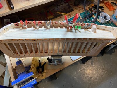

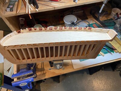

The aspen worked well for the deck planking, the strips were a little fuzzy coming off the saw I used 320 grit sandpaper to clean off the fuzz it was fast and easy. A few deck items will be added before the treenails. This is the progress photos.
Mike: I would, but I have to con someone into drawing bulwark extensions on the bulkhead drawings first!!! :D:D:D
Check Kens latest post.
View attachment 232821View attachment 232822View attachment 232823View attachment 232824View attachment 232825
Good looking deck. I love he cannon. MikeJ
Thanks Mike, I made the cannon to check for clearances in the gunports, looks like they will be fine. I will be adding the guns to the model.

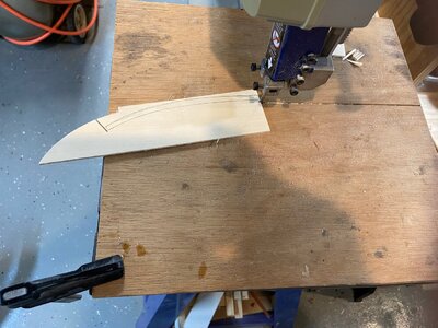

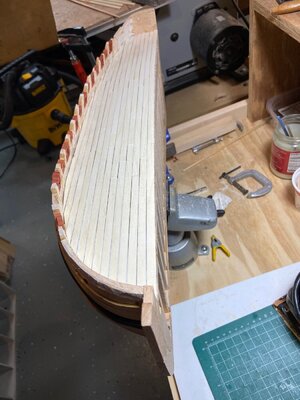

I spent all morning adding a waterway that will probably not be noticed. Since I did not do a particularly good job smoothing the filler between frames, I used a contour gauge and ship curve to make patterns. This is some progress photos.
