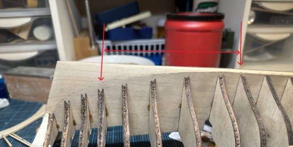

Would appreciate input from the Council of Master Craftsmen on an issue I noticed before I started gluing the bulkheads.
As you see in the photo, most bulkheads do not meet the bearding line
Although the photos in the @lauckstreet practicum appear to show that Bob had the same issue, there is no mention of the discrepancy or whether it needs to be addressed.
My assumption is that I need to fair the bevel for the rabbet into the bulkheads regardless of where the bearding line is drawn to ensure a smooth curve as the planking progresses down to the keel.
Anyone have enough experience to either validate or invalidate that assumption? @The Gavel Chuck, did you experience this with the Lovely Renee?
Anyone have enough experience to either validate or invalidate that assumption? @The Gavel Chuck, did you experience this withe Lovely Renee?

I'm sure I had the same thing happen - pics
First a marked copy of yours. Second a marked copy of mine (inverted for easy comparison).
I'm not sure I gave it a lot of thought and my solution is probably technically/historically wrong. I used an extrawide plank for the garboard strake that I'm sure I feathered a bit where it met the deadwood. AND I beveled it pretty sharply where it needed to meet the bearding line. Second plank was a bit narrower. I don't think I did anything much to correct the fairing into the given bearding line - maybe just a bit more sanding. As you know the garboard and second planks lie flat against the deadwood as do the next four (the way I did it.) I got a good smooth transition mainly by sanding at the very lowest part. My advice - go for it!

Thanks, Chuck. That’s helpful!
I was reminded again yesterday that there is little room for shortcuts in this hobby. After seeing so many builders put spacer blocks between their bulkheads, I’m not sure why I thought I could get by without them. But just using a batten to check my fairing, it became clear how much flex there was in the hull.
