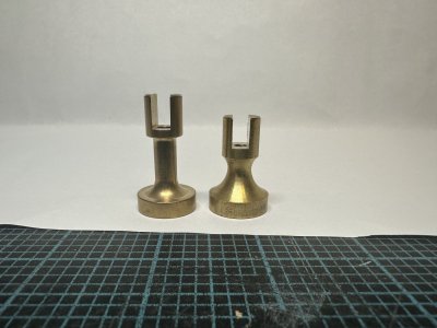

I ordered a pair of Model Expo brass pedestals from Hobbylinc (because they are out of stock at ME) only to find that at some point ME changed how they do things (no surprise) and the two pedestals-height difference aside-look nothing like each other
So now I’m left with a choice whether to just go with what I’ve got or, alternatively, order a second pedestal in the same size and then figure out a way to raise or lower it 1/4” to achieve the proper deadrise. :mad:

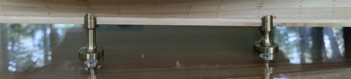

Namabiiru! I feel your frustration! Here's what they look like on my Lovely Renee. I don't think you should be concerned - no one is going to notice! They'll be looking at your ship!View attachment 537578

That's fair (no pun intended), but I'll notice, and it will possibly drive me crazy. I suffer from CDO--it's like OCD, but in alphabetical order.
BTW, it looks in this photo like you have a glass base. Is that so? I love the rich bronze-like finish on your pedastals. Did you do anything special to achieve that?

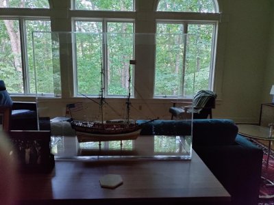

Not glass - plexiglass. The admiral likes the modern look of the plex case with no wood. Happily, it suits my tastes as well.:cool:

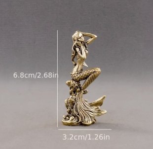

I can understand you. It has to look absolutely perfect. That would always bother me too. I've already chosen a ship stand too. I wanted to put the Athena on four mermaid columns. I thought she was soooo beautiful . The figure is made of brass. What do you think? All the other ship stands are so boring ... Otherwise I'll build it myself.

I think that will look fabulous! You'll have to chose names for the mermaids with great care.
Yes, I do my friend!! I called this mermaid "Doris"; it is the name of my wife. :D
The female first name "Doris" comes from the ancient Greek tribe of the Dorians. "Doris" is also a short form of the name "Dorothea". "Doris" is derived from the Greek and means something like "gift of God" or "gift of God".
