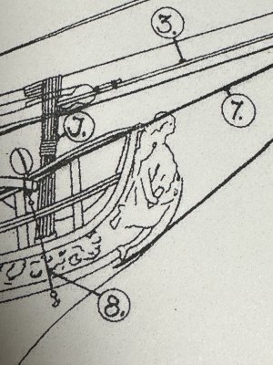

So, I figured the kit must depict the figurehead that way for a reason, which is undoubtedly reflective of the Rogers Collection, but nearly every figurehead I have seen was either entirely below/forward of the stem or straddling it.LOVE IT! I wanted to add hair because the real Lovely Renee has awesome hair, but I coouldn't think how to do it. You did a brilliant job! I don't know what the flat lower front is meant to be. I know I filed it down so it would fit in the given notch rather than on the front of the stem so they were largely obscured and I did the whole figurehead in gold. I'll check my references for the Rogers' collection model. If there is any thing interesting, I'll share it with you.

I had found this depiction of the figurehead in the plans, which is clearly more robust than that provided in the kit and obviously and a better fit for the notch

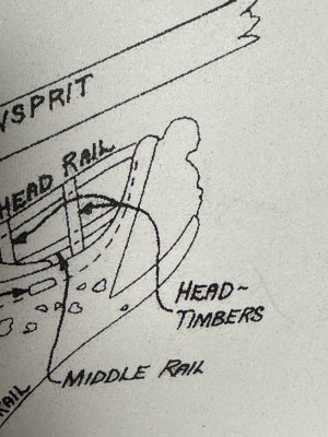

After the mod I found this depiction of the figurehead, which seems to show it as straddling the stem
Unfortunately, pretty much everything below the waistline is missing and beyond my ability to replicate.
All that is to say that, yes, in relation to other FA builds, mine is certainly an unorthodox approach; but I think in light of what the kit provides for a figurehead, my depiction is pretty consistent with prevailing practice. At least that’s what I keep telling myself!
Anyway, I provide all this mansplaining for the benefit of some future builder. Considering what a puzzle it’s presented for me, I haven’t seen any other build logs that make any mention of it.
Anyway, I’m awfully glad I got it sorted (one way or the other) before mounting the stem
