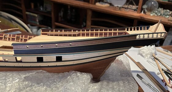

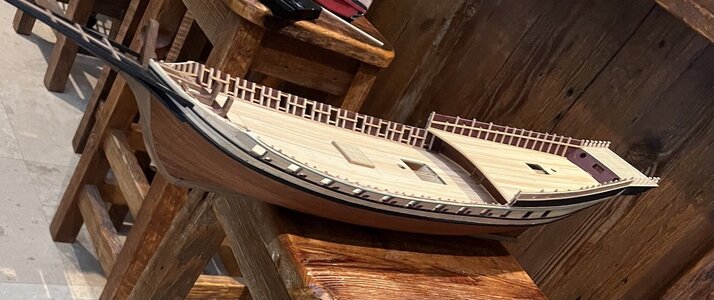

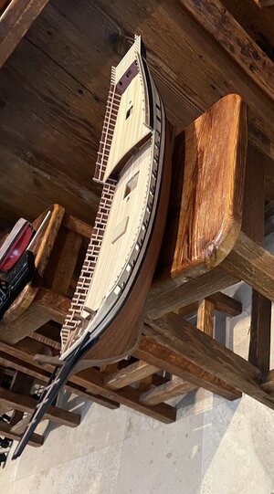

Good morning. Apologies I got side tracked yesterday and forgot to send pic I promised.

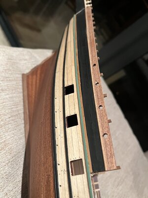

The stern bulkwark is made in two parts - I have had to scratch build the entire stern. This is 8mm lower, 20mm longer and carries more aggressive curves than the Cazador. Excuse the wood filler and shade variations this is still WIP.
You will notice my fight with wood veneer continues another chip on the 3rd gun port. It’s ok I know how to fix these now:).

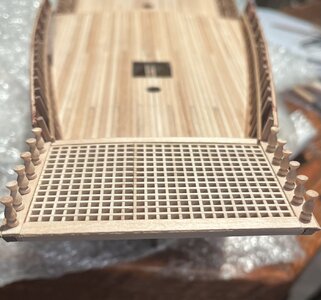

I bought some 8mm railings for the Heli deck.
Progress so far :
Cheers Grant

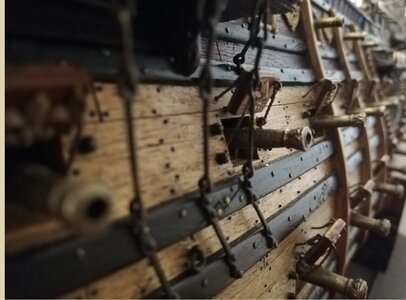

Good morning. Good old SA power cuts again this am and I did not charge my lights so I decided to spend time in the scratch build logs again. I thought my scratch built stern was cool….whaaa haaa. ROTF. Check this scratch build out from Andrey @Mr.Deep -
View attachment 379112View attachment 379113
Cheers Grant
I saw that one too. Andrey said he didn't make it, but found it online and shared it with us. It is a beautiful piece of work.

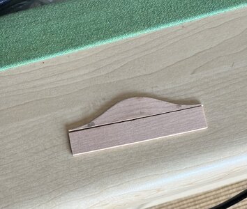

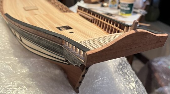

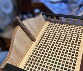

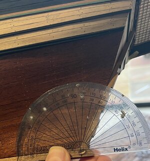

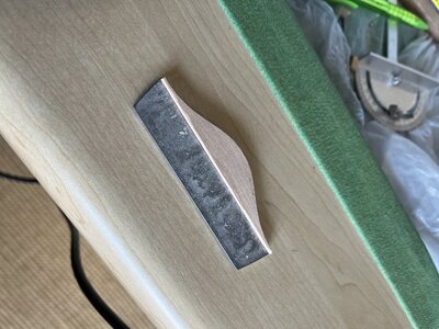

Good morning. The stern (Heli deck) board/transom. I liked the shape of the Cazador kit however needed to remake this due to dimensions. (Lower, and more rectangular).
I used the Cazador cast decorations and tacked my wood onto this. Then sanded the shape. Not much wood left so have make a plan- used two pieces.
I wanted it angled at the same angle as the hull stern: Doing this by hand - I had my doubts if I would get this right! Confirmed!

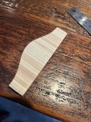

Planked the inside with left over deck planking and the outer with Sapele veneer.
Result: I framed the “transom” with Sapele veneer. The boom support strake is walnut 3x3 and I scraped some patterns in for some fun. The railings are just plonked on for effect. Covered the unavoidable (well Grants sanding angle skills) gap with a 2x1 walnut cut from left over Victory plank.

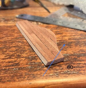

I glued the railings on:
After a little wood filler, sand and paint fix up:
I knew it- hand sanded angle was not spot on. I’m leaving this as it is still cool.

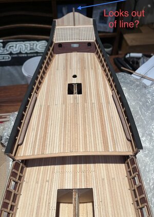

Photos….ROTFmy support looks screw. I will have to check this out. I did use a set square but could have move when clamped this….WIP.
Cheers Grant
View attachment 379292View attachment 379291
View attachment 379296View attachment 379297
Cheers Grant
Well thought out, well executed transom piece Grant. Not sure about that verticle piece, it does look off a little but its parallel with the planking and they look good??
Cheers Grant
It must be camera parallax. That's always my excuse.
