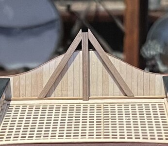

Well thought out, well executed transom piece Grant. Not sure about that verticle piece, it does look off a little but its parallel with the planking and they look good??
Smart work Grant. I agree with Daniel; the vertical support on the transom does appear to be parallel with its neighbouring planks, and therefore okay? Maybe the ship hit a sandbank and tilted at the very moment that you took the snap :p
Good morning Daniel and Mark. Thanks for the compliments. Luckily this time around it was the parallax. Mark the only sandbank this Xebec hits is the the one in Melkbosstrand- Grants treacherous bank.ROTF
It must be camera parallax. That's always my excuse.
ROTF . Good morning Vic. Thankfully this time around I didn’t need the excuse. Did give an “OH No “ (putting it politely) moment tho.

Good morning. Double checked - it is at 90• and the extended deck and “suspended transom” are all symmetrical to the rest of the ship. (Whew) .I cut the two identical support strakes for the boom rest. I’m still trying to work out what this boom is used for with the lanteen sails. Number 145??
I changed the layout from the Cazador and Ancre Le Requin (shown in above photo)as my “suspended transom” is lower and it just didn’t work for me.

Again I thought what up as the SB strake does not equal the PS relative to the planking lines? Everything is spot on when I measure. I know the deck plans are irregular in width so I’m putting it down to that o_O. There again Grants measuring……ROTF

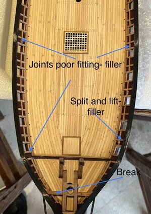

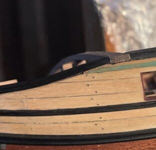

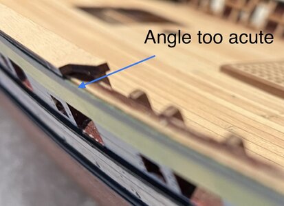

Well the main deck rails were like a hangover after a night of no consequence. As you know I changed the bulwark shape and angle and this created some pain.

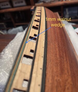

Step 1.
The walnut Strip above the green ( Grants creation) had to be shaped in to a wedge or the angle of the railing was too acute and the railing slopes downwards.

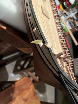

Step 2.
The pre cut kit railings had to be curved more aggressively….SpeechlessSpeechless.Being laminated the heat and water separated the laminate. When I just attempted heat only it snapped. Swear jar full by now :
I eventually went for wood filler and sandpaper. ( luckily these are painted or I would have problems)

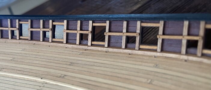

On the inside it was important for me to get the railing flush with the Bulwark “frames”/supports. Mostly achieved:

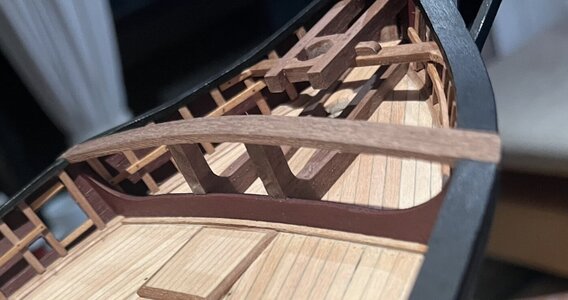

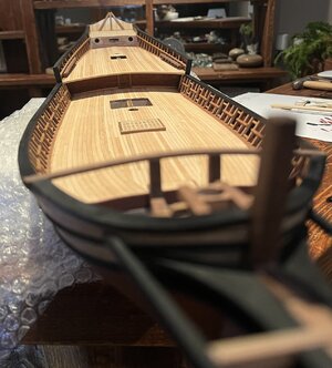

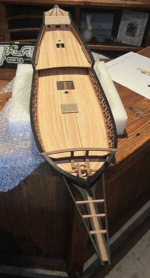

Step 3 : measured…(eish) the cuts for the cat Davit and sawed/hacked. Again variant from the kit I wanted this flush with the rails and a sexier curve.
Here they are : with the sexy curve;)
Not the greatest fit - SB side better but need to show the not so pleasant as well.
After 3 mornings and many full swear jars :

Keep going Grant, you can do it son! Just grind through the pain, empty and re-fill the swear jar as appropriate, reap the rewards. I have to take your word on the minor issues you are experiencing because from this angle it all looks pretty good to me? :)
Step 1.
View attachment 379766View attachment 379767
Step 2.
View attachment 379771View attachment 379770
View attachment 379772View attachment 379773
Step 1.
Step 2.
Step 1.
Step 2.
