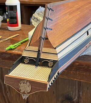

Good morning. We have had some beautiful winters days and have capitalised on this while we can- not much Xebec time.
The rudder : This little bugger fought with me hard….I had to reshape her due to my hull shape changes, redesign the Occre kit fitting etc etc.
Grants design. Not accurate however I was not going to fill the notches on the stem. Just looked ugly. So the kit was modified.
1. The rudder had to be cut and reshaped to fit the false keel
2. The rudder was bevelled on each side
3. The notches in the rudder were filled with cut out walnut. The kit pins were too large so I used 6mm copper pins. These are supposed to fit perfectly into the notches on the stem. ROTF- Did what I could.
4. Extended the top of the rudder as my hull changes made this all longer
5. Used the kit hinges. I would have preferred them narrower, however I had to go with what I have. Acid, Roughed up and painted with primer paint. Man I need to get some brass black. Will be an expensive mission but I’m over my brass painting efforts.
….and of course where the tape was left a change of wood colour:mad:. I’m sure I can sand this off and hopefully will not be seen when I put poly on.
Tiller :
Rounded the edges of a 4x4 walnut, wet, heated and shaped with curve. I added a little handle to assist my crew for fun.
The whole mechanism actually works….ROTF

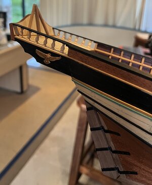

Good morning.

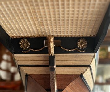

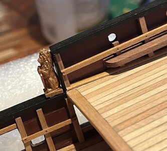

Cheating time :D :
I know I cannot whittle wood as those magicians Peter (@Ptèr ), Dean (@Dean62 ) , Maarten (@Maarten ) and many others do. The kit decorations do not fit my Xebec in any manner so I cheated and bought a resin 3D printer. Lol it was cheaper than the three 3D Parts I bought for my Victory….go figure.
To design correct and accurate designs one needs to buy a CAD program and go to universityROTF. For Grants Xebec Im just going to download some free STL files and create some decorations. I will have “go to University” before my next ship which hopefully will be a historical replica. I have missed the research and discovery aspect of this hobby with this build.
My theme - Lion and eagle. After splicing (Using Lychee splicer ) this is what came out.
All stuck on with Prestick and painted with antique brass. Sorry Dean @Dean62 and Paul @dockattner ,no artistic dry brushing and fancy work- just dip and paintROTF.

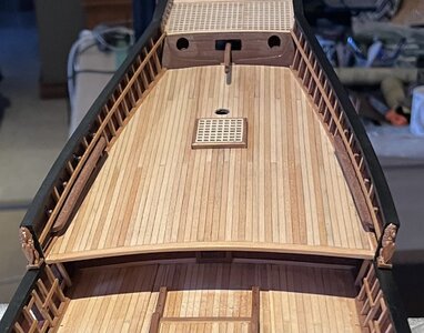

Modelling- I framed the stern with walnut, and the underneath with Sapele veneer. I have basically run out of 1mm walnut left overs from the Victory so no redos available- Eish!
Problem….The emblem,only free STL I can find, of a lion and an eagle which shape works, is the Armenian emblem….what a landlocked country has to do with a Corsair Xebec who knows Redface. Ah well let’s see- was fun.
