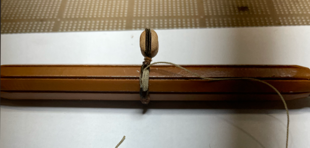

So I rigged a few blocks. But to do them as well as I hoped required some clamping action...

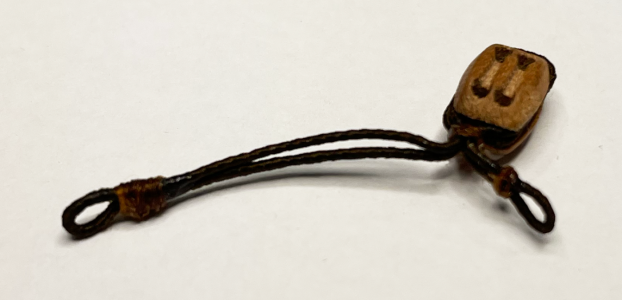

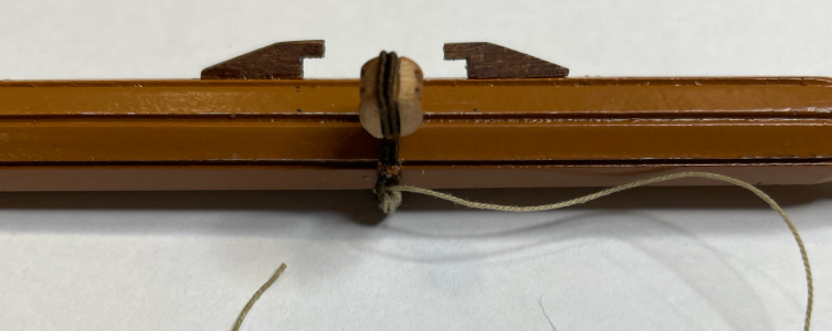

Made the Main Topsail Yard Tye. This took me awhile - sorry about the focus... my camera skill is questionable.
So I learned a number of things when I created this assembly:
1. Serving small diameter (0.35mm) rope is a 1766618472695.pngchallenge.
2. Making a served rope perform a loop without the serving "spreading" on the turn is, ummm, difficult.
3. A one-armed idiot should not attempt this type of delicate construction.
I was really proud of my lashing on the tye, until I discovered that I had the rig reversed, and had to disassemble it and apply it to the other side of the yard.

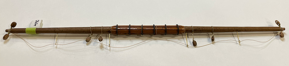

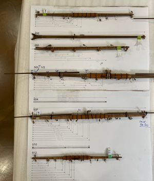

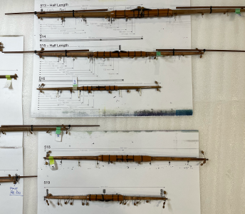

I've been working on the yards, and have them completed except for the footropes. I haven't determined exactly how I'll get these to hang correctly, but I've got some ideas.

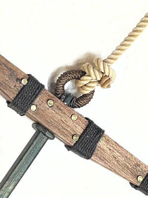

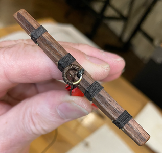

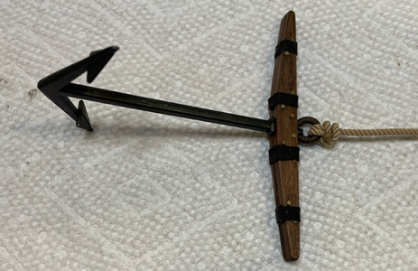

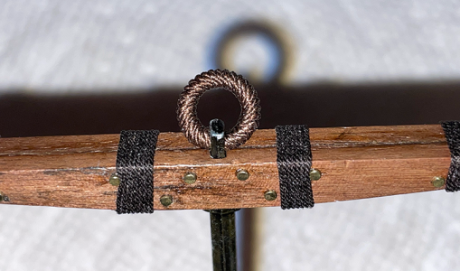

The reference I have indicates that the anchor ring should be "served". I tried several diameters of rope and finally settled with a rope that is clearly not the correct diameter, but my feable fingers were able to serve it correctly:
During this process I discovered that the serving looks more realistic if it is wound in a clockwise direction around the ring. If served counter-clockwise the rope looks twisted (as shown above). Oh darn. I did not re-do the rings that I already completed though. Yup, lazy bugger!
I used the "modern day" anchor bend knot for the attachment of the rope to the ring as it looks very neat. I made some cable rope, but was unhappy with the look. So I went with my usual rope for this, which I like the look of better.

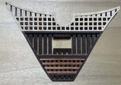

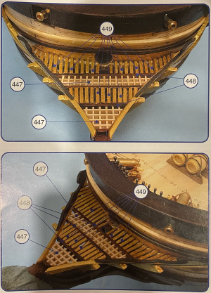

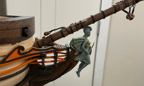

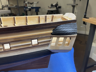

After completing the anchor details, I went back and worked on the ship's head. As I've mentioned previously, I'm less than proficient with grates, and the ships' head uses a number of them. The following pictures are from the A.L build manual.
You probably cannot hear me gag when I look at these. So, in an attempt to make my ship look like it has a decent head, I made my own grates from scratch. Bad idea? Probably... I'm crap at this stuff.
I made several "accurate" templates using empty cereal box cardboard and built the grates in stages and test fit each to the ship before final assembly.
Here's what the head looked like before final installation:
And here are a few shots of the assembly in place:

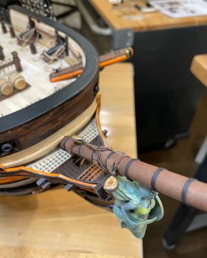

Was it another error not to crop the figurehead boobs out of the photo? Well, I'll claim I left it uncropped to inspire a good look at the ship's head.
Yeah, right.
A final look. Yes, the bowsprit is "resting" on the figurehead. That is only temporary and will lift up about 1ft above her when the stays are rigged.

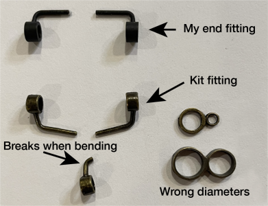

For those who may be following my build, and have the same kit in drydock, note that the supplied yard boom fittings are unusable and I made my own. The yard-end brass fittings have a significant angle to them rather than a 90º angle. I tried to bend these to the correct angle and the brass is very brittle and breaks. Even with a heat treatment... And the figure 8 rings are not the correct diameter as specified for the various yard tapers.

The puddening on the ring looks terrific. :)
Is there a reason you used rope around the stock instead of metal hoops? I can't find any contemporary based information that shows rope instead of metal in any second half 18th to early19th centuries English ships. Sutherland's Shipbuilding Unveiled , Science Museum pics, etc. all show metal hoops. I am guessing the hoops varied in size but Lavery shows a drawing of a 39CWT anchor with hoops that were 2 1/2" wide by 5/8" thick which gives a little indication of the hoop size.
Thanks
Hi Allan,
I'm still learning the nomenclature for some of these ship parts, but I'm not sure what you mean when you say "stock" - I'm guessing that is the wooden crossbeam on the anchors.. As this is my first attempt at constructing a wooden ship, I'm mostly just following A.L.'s kit plans. So where you see rope on my ship, and anchors, that is what the plans called for. However, I did not use rope when I secured the reinforcement battens to the yards - for those I made my own metal hoops (the kits plans called for rope here too). Shrug. Clearly I'm making all the typical newbie mistakes, but I'm trying not too. Thank you for pointing this detail out. If I build another model, then I'll do the anchors correctly.

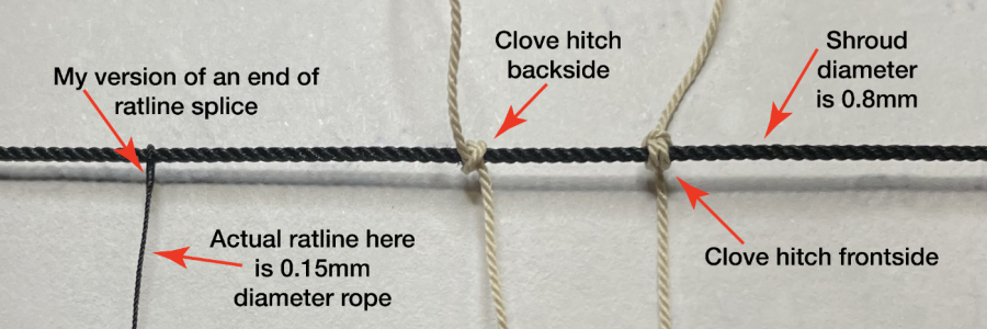

In preparation for having serviceable fingers on both hands, I have tried a couple of samples of the hitch knots that I'll be using for the ratlines. Fortunately I have been tying hitch knots for many years. In doing so, I find that one side is "prettier" than the other. In the image below I show a closeup of what I mean:
So I prefer the clove hitch frontside view, as it looks very tidy. I haven't done any research to determine which side of this knot should be outboard or inboard on the shrouds, but as my model will always be viewed from outboard, the clove hitch frontside view is what I'd like on the outboard. If this is a gross error, please correct me. As a Monty Python skit quote said, "a spanking may be called for...." But, as I haven't really started on the ratlines, a correction now is better than later.

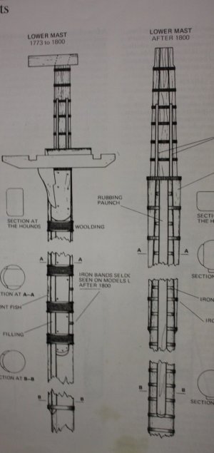

Are you speaking about the rope wooldings and the thin wooden rings on the top and bottom of the wooldings? Some kits do not provide for the rings.
From James Lees' The Masting and Rigging of English Ships of War.
A.L. did not include the wooden rings for the masts,
That is no "surprise" :)
As you wrote, for down the road, there is a post in the Tricks of the Trade topic here at SoS that shows an easy way to make wooden rings and hoops that may be helpful.
Yes, I saw this reference in that book
As you have a copy of Lees' book when it comes to masting and rigging you have a huge advantage over those that do not.
