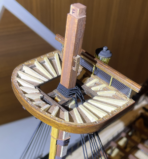

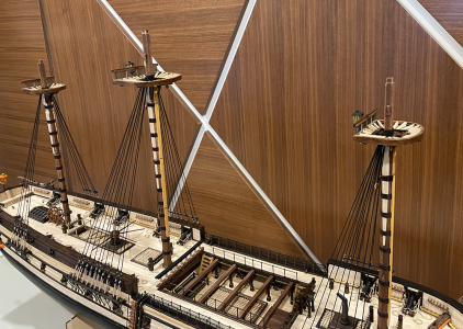

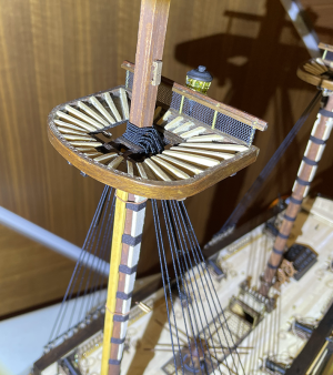

So I did manage to take a few photos of the initial rigging of the Surprise. Yes, I made a ton of errors. I'll correct these on my second build.
My fingers are not working very accurately yet, and I'm finding my progress to be very slow. I don't want to screw-up the model more than I already have, so I'm working on non-critical parts. The parts I've chose can be re-done without hair loss - not a real concern of mine at the moment...

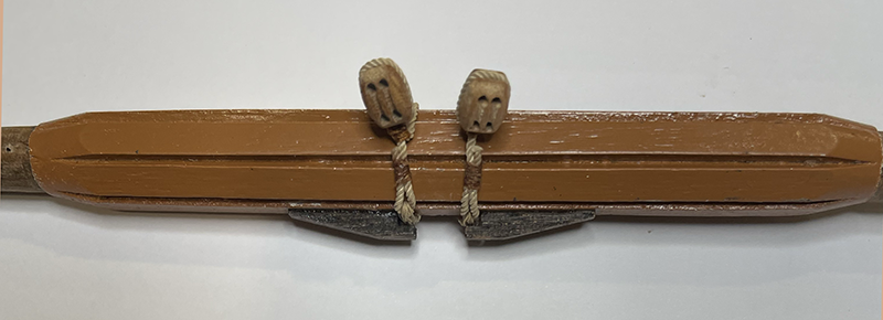

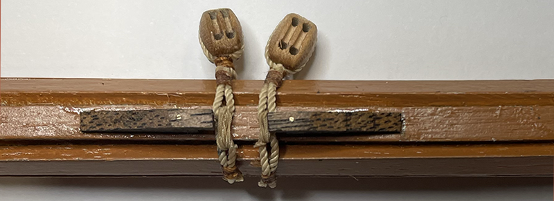

My first attempt at the foremast jeers:

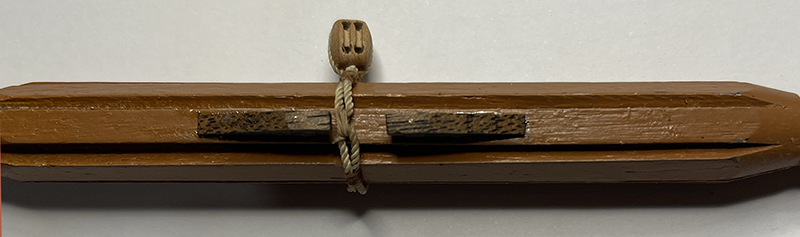

Second attempt:
Top view:
I know that these should be served and doubled, but that is beyond my current finger motor function.

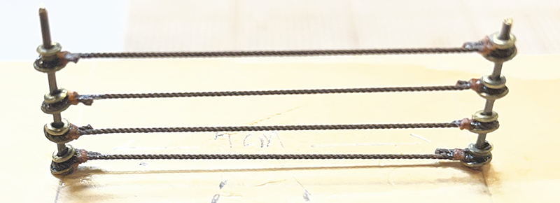

Also made a "weak effort" at making 1mm thimbles for the catharpins. I know that I will improve this "skill" eventually:
The jeers for a single yard took me an entire day, and my fingers were shaking with exhaustion when I quit... but I still am happy to be back to my project. I will not be posting very often as I expect my progress to be greatly reduced.
Good morning Reg. wow you have been through some tough months. I hope they got that tumour and you are on your way to recovery. Rigging these ships of the line is no mean feat and so far looking very good. Lovely ropes BTW. Cheers Grant
Good morning Reg. wow you have been through some tough months...
I'd like to think the tough months are behind me. Time will tell. Thank you for your kind words Grant. They are very much appreciated. I did a lot of reading while in the hospital, and have come to realize a bunch of errors with my build. These were all caused by incorrect kit instructions. Allan pointed me at some great books which I have been referring to and will help me to avoid more gross errors in this build (I hope). Enjoy your summer and best of the season to you sir!

Is the rigging you are showing for the jeers from the kit instructions? It is a good idea to double check anything in AL instructions with well researched sources if such things matter to you. FWIW from James Lees' The Masting and Rigging of English Ships of War 6th rates and below used two single and one double block for the jeers until the last half of the 18th century and toward the latter part of the 18th century a jeer tie was re-introduced on ships of 28 guns and smaller. It consisted of two single upper blocks, and one single block on the yard.
From Steel's The Elements and Practiced of Rigging and Seamanship.
JEARS, in merchant-ships, and small ships in the navy, have two single blocks lashed on each side the mast-head, as above, and another, the same size, in the middle of the yard. The tye, which connects with these blocks, reeves through one of the blocks at the mast-head, then through the block on the yard, and afterwards through the block on the other side the mast-head. In the lower ends of the tye is spliced a double-block, which is connected by its fall to a treble-block, that hooks to an eye-bolt in the deck, close to the mast, on each side. By this the power of the tackles below is communicated to the tye, which, connecting with the block upon the yard, easily sways it up, or lowers it down.
Hello Allan, the answer is yes and no. The kit instructions called for two 7mm double blocks and didn't mention how to attach them precisely. So I referred to Lennarth Petersson's "Rigging Period Ship Models" book, page 35. As my model is basically a "fantasy / fictional" ship I didn't do any further research.
I should not have assumed the model was supposed to be Surprise 1774 or Surprise 1796 as I did not realize your model was a fantasy ship. Totally my fault. :(
Keep in mind the Petersson book is based on one fifth rate ship model, HMS Melampus and would not be appropriate for some things such as the jeers for a sixth rate. Melampus 1785 jeers would have been two doubles and one single. The drawing in the book shows two doubles and two triples which was used on a first rate and would not have been set up that way on actual 2nd through 6th rates.
In the end go with what makes you happy as that is the number one priority!
