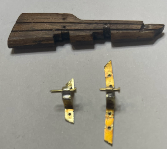

Re-worked the longboat hinges. Soldering these is far easier than bending the brass strips to accomodate the hinge pin. I used 1.2mm OD brass tube with an ID of 0.7mm. The hinge pin slides in as easy as the hinge pins on my house doors.

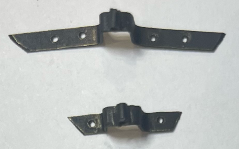

After blackening the solder joints:

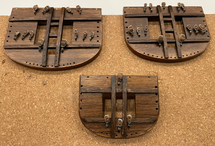

Just commenced the first part of the mast rigging. I assembled the tops earlier, but forgot to add the screen at the rails. Forgot? Or procrastinated? The screens were a pain... but I got them done (if not perfect).
Now working on my block rigging technique. I experimented with line splicing these blocks but need to improve that skill before I take-on small diameter rope.
The closure with netting looks really good and so nice that you included it. From James Lees The Masting and Rigging of English Ships of War page 23 to compare with Artesania Latina's concept of tops. Note that the holes for crow's feet extend nearly to the outboard sides which you can add if you want to.
