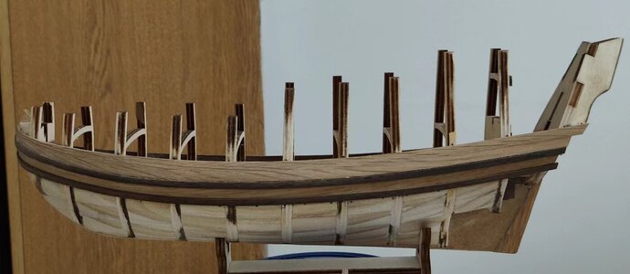

This is so impressive, especially when one takes into account the limited toolset used. Bravo!
Thank you, Johan. There are still a few finishing touches that are required, but I am satisfied with the basic work done.
Oh boy! That oak/ walnut contrast is just outstanding Heinrich. I love the innovation with the drawer! I,m really glad to hear that partial gluing at a time of the planks really works. I have battled with that on two ships now and always had a difficult time reaching the narrow space where the gluing left off and had to move further down to start gluing again.
Let me guess; complex double curvature, oak, troublesome handling characteristics?
It does look spectacular though.
Hi Johan. All of those things you mentioned came squarely into play, plus the fact that the oak does NOT want to remain bent. Compared to the oak, the walnut was a breeze in the park. BUT ... the looks, the looks! I also think it looks really good - now it's up to me to keep my concentration, remain focused and exercise patience.
I am glad that you like the oak/walnut combination, Daniel. As you know, that was the plan from the beginning. :D I know exactly the problem you are referring to getting the glue in those tight places - all you do, is dilute it very slightly with water, apply it as deeply into the crevice as you can get it, and give it an almighty blow! The glue will spread and cover the whole area.

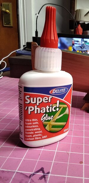

Hi Heinrich,
Super PHATIC ALIPHATIC Glue Fast Drying, Bonds Wood, Foam Paper ETC Brand: Deluxe Materials​
If you have never tried this adhesive before I would recommend it. It seems to have a very low surface tension and therefore sucks itself into realty tight places. Just touch it to the side of a plank and it will suck under it. Great work btw.. Fibrous wood is a pain in the you know what. Cheers JJ.
Hi Heinrich,
Thank you very much for that tip, Jack. I have heard so much about it but have never tried it. The big challenge is, of course, to find it - or equivalent - in China. What brand do you use or are they all the same?
Hi Heinrich, Yea the one I use is the super thin one from a company called Deluxe Materials. It has a very low viscosity and as I said get right into the tight corners. Its not a substitute for pva but more of a compliment. It grips slower than a super glue, but faster than pva. It dries clear with a slight gloss and is water cleanable. I would also use it when rigging to stop knots slipping as it doesn't go bubbly white like super glue can sometimes. JJ.
Wow I like that look. The oak really stands out. VERRRRY nice.
Thank you very much for the kind words, my friend - I am also very pleased! :)
Thank you very much for that, Jack! This weekend when the admiral is here, I will ask her to look on Taobao to see if we can find that - or at least, something similar. Much appreciated! Thumbsup
For someone who likes wood and likes working with wood, you have to be pleased with that Heinrich. Nice work Thumbsup
Thank you for the very kind words, Mark. I am extremely pleased. The oak is a real challenge to work with, but it creates almost seamless lines without sanding and then sands to a beautifully smooth finish.
