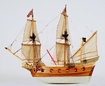

Have a look at this picture of Ab's model.
I am not sure what color Ab has painted his bulwarks from midships to stern, but to me it looks like it might be black (Ab has used black quite a few times on some of his previous models). So now I am even playing around with the idea of using black hornbeam and oak inserts planked horizontally. Then, of course, painting below the waterline will also be something that I will have to make a decision about.

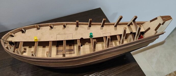

Today was another busy day in the shipyard but there is not a lot to show for it. However, it formed part of what I call my "Checks and Balances". If I want to build a truly accurate model, I have to pay particular attention to this.
Even though laying down the deck only comes much later in the build, I know myself - I had to see how the curvature of my "reworked" hull stack up against the curvature of the deck. If there were big discrepancies here, it would point to an incorrect hull shape. Normally @Kolderstok Hans supplies a deck which is well oversized so that it can be sanded to the exact line. On WB #1, I wasn't a big fan of this idea as I had to remove quite a lot of material. Today, I could not thank Hans enough! :D I used every mm of that deck and then had to cut the notches considerably deeper so that I could slide the deck fully home.

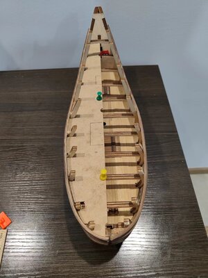

So, this is what the dry-fit looks like on the Starboard side with only two push pins to hold the deck down temporarily.
I was very pleasantly surprised to see the deck fits this well and for the deck and hull line to be virtually identical. I have a build!!!:D (I went a bit overboard on the notch at Bulkhead #2.)

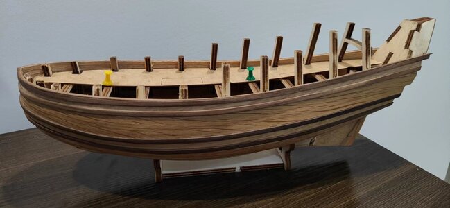

This picture shows how nicely the deck line follows the sheer of the hull on the starboard side with the upswept at the bow. Note how the planks join at the bow.

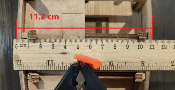

Thus, I am happy with the visual lines and fit, but let's go to the ruler.

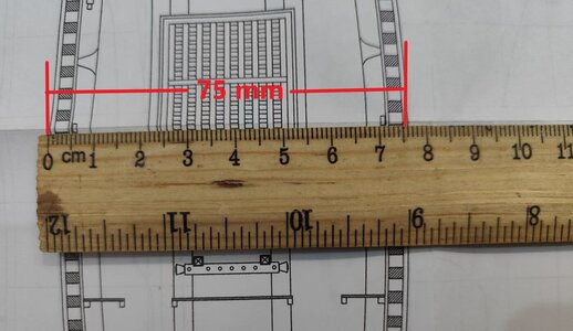

The widest point on the upper deck measures 7.5cm according to Ab Hoving's plans. Ab builds in 1:75 so that distance converted to the 1:50 scale of the Kolderstok model comes to 11.25 cm.
On the picture it looks like 11.1, but viewed from the top, I get 11.2 ! :)

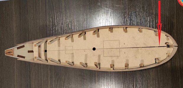

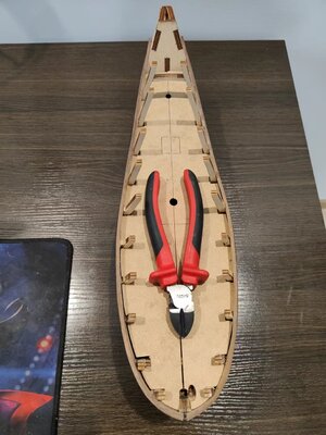

I have fitted the Port Side of the deck and ...
That is just what the doctor ordered. If I had wanted to spend more time on the fitment I could have gotten the deck to fit even better, but that is not the purpose for now. To think that you have designed a hull that conforms so closely to Ab's interpretation, is just amazing.

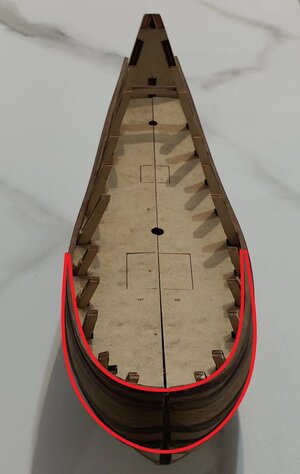

The "gap" where the two decks do not meet in the center is NOT a mistake - it shows exactly the amount by which I have widened the hull towards the bow. That is how accurate your deck is shaped. Note that cap rails have also been installed.

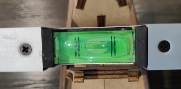

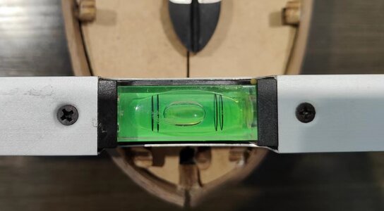

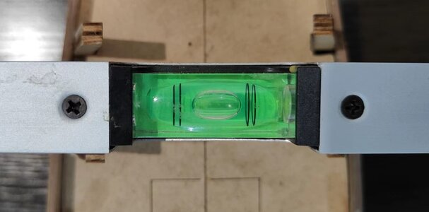

And seeing that I have also installed the cap rails, I simply had to pull out the level again.
Stern
Midships
Bow
Thank you, Hans! This is one super-accurate hull!
