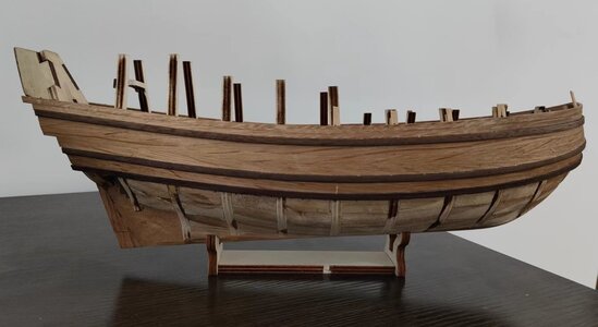

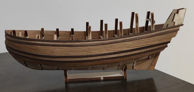

The first-level planking on the Port Side has been completed.
With that I am well pleased. Now there is one more plank to go on the Starboard Side to create the correct height and then double it into the next "false wale" as per @Ab Hoving Ab's plans. I must tell you that the more I get into this build and am beginning to understand the mechanicals of it all, the more impressed I am with Ab's knowledge and plans. In a next life, I would really like to build a POF model completely based on Ab's plans.
It's already looking superb Heinrich Thumbsup
Thank you very much my friend! Planking is just very s-l-o-w. As you can see I can only glue portions of a strake at the time. Then it is a 3-hour wait for the glue to dry properly, wet the remainder of the plank and on to the next portion.
Slow but sure, good old tortoise and hare stuff. I can't imagine racing through the planking process on any day of the week. Your patience will yield superb results I'm sure Heinrich Thumbsup
Mark, you are absolutely right. I only have the single layer planking to do, so I can afford to spend the time required to get this right.

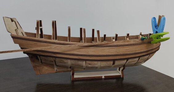

Heinrich, good afternoon.
Did I read correctly that you glue part of the rail, wait for it to stick together, then soak, bend and glue the other part? This method can lead to some trouble in the future. After the wood has completely dried, gaps may appear between the slats. I can offer you an alternative option: wet the rail completely and lay it at the place of future gluing. Wait until it is completely dry and takes the desired shape. And only after that glue it. Yes, this method is also not fast, but it is better. I had to use this method when I bent and glued velvet strips with a thickness of 3 mm. He works.
My dear Sasha. Thank you for suggestion - that is what I have been doing all along. However, "our" method does not work with oak. I have soaked the oak planks and left them clamped on the model for a day to dry. As soon as the pins and clamps are removed it just straightens out again and loses its curved shape. Now I wet the whole plank, glue and clamp it in place as it as far as it will go, re-wet, the rest of the plank and carry on. This method of working with wood was explained to me by one of the Dutch masters and while slow, it works perfectly. I have never had problems with gaps developing in my planking. My Batavia has been through three years of China's extreme cold and humidity with no adverse effect.

Funny is, this is the way I mostly glue the planks onto a model - step by step - but I never mention it in the building instructions of the Kolderstok Models. :-(

Thank you for this, Hans. It is difficult to explain to others unless you have experienced Kolderstok's wood. I keep on saying that your wood is "real" wood - I know it makes no sense to others, but Kolderstok builders will know what I mean. If I look at the planking strips supplied for Bluenose (1.5mm x 4mm Pear wood), it SHOULD be the same as your 1.5mm x 4mm walnut strips (I am purposely not even talking about the oak here), but the two are worlds apart. I can bend the Bluenose strips by waving it in the air! Try that with Kolderstok's wood.
I have very seldom had to plank the walnut in portions (only in the rarest of cases), but the oak is just uniformly "stug". However, I believe I am over the most challenging part now - below the waterline, I have my filler blocks to help. :D And, I must say, I am very happy how the above-wales part turned out. The surfaces are absolutely level, the bulwarks extend higher above the deck surface than on the previous build and I know (according to my gut feeling) that I have just built a much more accurate hull than WB #1.

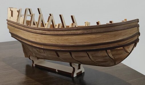

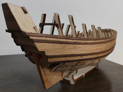

I am happy conclude a nerve-wracking few days in the shipyard.
The final plank on starboard side has been laid down.
Which was then doubled as the "false wale".
To say that I am happy with the way that the wales meet at the bow would be an understatement. :) (I do permit myself a small smile)
Port side reminder.

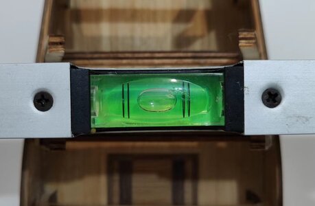

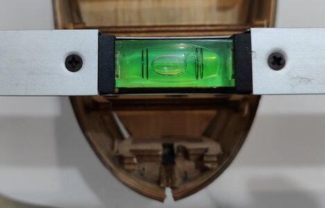

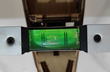

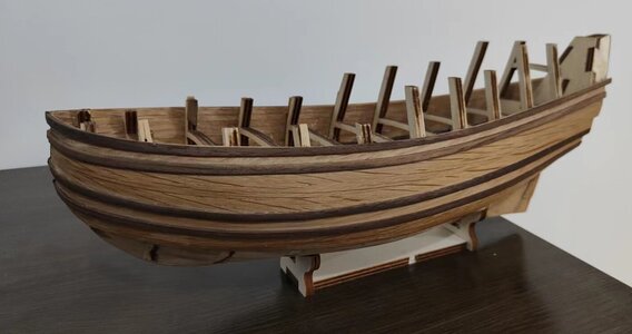

Yes, but how level are the bulwarks now after all these planks have been laid and all the conniving with hull lines ?
Bow - Check.
Midships - Check
Stern - Check

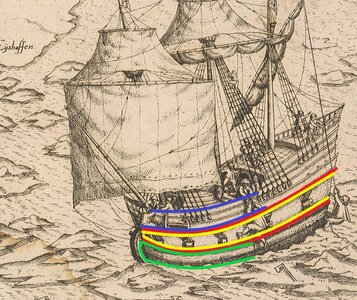

This drawing by De Veer shows the objectives of this part of the build.
Green: The more rounded bow.
Red: The upsept wales which create a "pinched" effect of the hull (Yellow)
Blue: A more substantial (higher) buildup of the bulwarks above deck level at the bow.
Have I succeeded? I leave that to you to decide.
Heinrich, you have succeeded! And it looks absolutely wonderful. The wood tones and the curves are a delight to the eyes. Even the heavy grain works to your advantage as it highlights the curviness rather than running against it (I trust that was intentional rather than being a happy coincidence). A one of a kind ship being built by a one of a kind builder. Who couldn't fall in love with that? Congratulations on what you have accomplished thus far.
