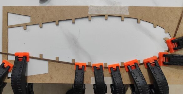

@Pathfinder65 Jan, this is my idea of bending the cap rails. First attempt in progress.
This is the 1mm x 3mm walnut plank which I'm doing a trial run on. For the thicker plank you can always add dowels alongside the inside curve of the deck sheeting to run your plank around. That is of course provided that you use a building board or proper worktable into which you can drill holes and not the dining room table like I am doing now. :D

That looks like a great idea. Instead of drilling holes in the Admiral's dining room table (OH BOY I would be toast :eek::eek::eek:. That table is a family pass me down) Yup, I'd rubber glue that outline to a board and drill holes in the board for pegs. I did that on my Enterprise build to bend the cap rails into shape.

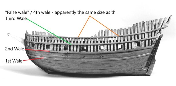

OK - so then my idea is not too far off. Jan, to answer you about the "false wale" (I call it that for lack of a better word) - yes, it's the fourth one or top one on my picture. Kolderstok's plans call for a 2mm x 3mm strip to be glued horizontally on top of the last 4mm plank. That means that you have a 2mm thick "wale" on which the upper planking takes place. However, if you look at Ab's build, you will see that he used a conventional plank which results in a much "thicker"-looking wale. As I say, it's not a real wale - more of a division between the above and below-wale planking.
The four "wales" The sentence that was cut off should read: "apparently the same size as the 3rd."

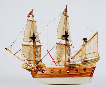

And on the finished model.
Both these pictures are from the book by @Ab Hoving "Het Schip van Willem Barents".
Hmm I'm a little confused. Above the third wale you laid two more 1.5 X 4 mm planks and added the "false wale" to the last plank versus the 2mm X 3mm plank??
No, I doubled the first 4mm plank into the third wale; then the second 4mm plank and then doubled the third one into the false wale. I have made many changes which I do not post because it would just be confusing.
