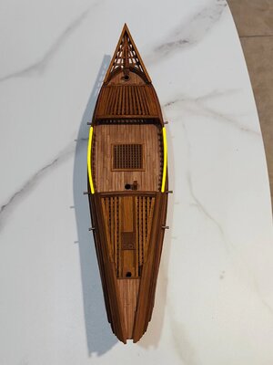

I have decided that for now, the attention has to be divided between:
1. The top railings of the bulwarks between the two canopies,
2. Placing the stanchions towards the stern and
3. Finishing off the stern section of the ship. (At the moment, the stern is still open and unfinished.)
The yellow lines indicate where the top railings will go between the two canopies.

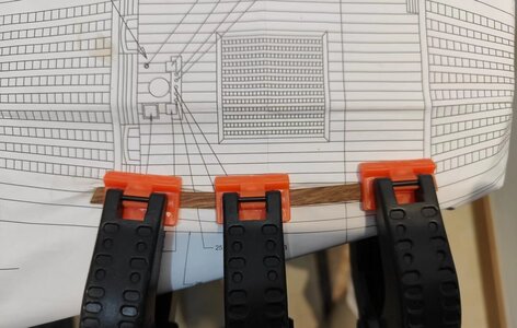

Top Railing for Bulwarks:
After soaking an oversized (over-length) 1.5mm x 6mm oak plank in hot water for about an hour, the plank was laid over the full-sized plans and secured with my heavy clamps in the correct curvature. That will be left in the clamps until tomorrow night to see if the oak plank maintains its shape. There is no way to tell beforehand if this will be successful, so this is a case of a trial and error.
The soaked in hot water oak plank has been clamped in position on the full-sized plans according to the required curvature.
