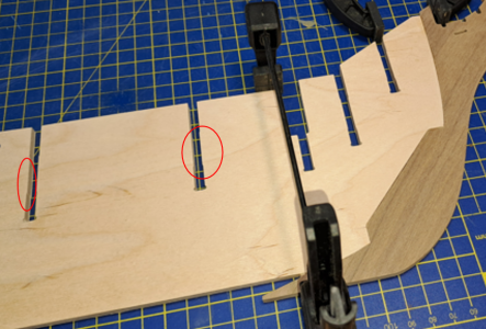

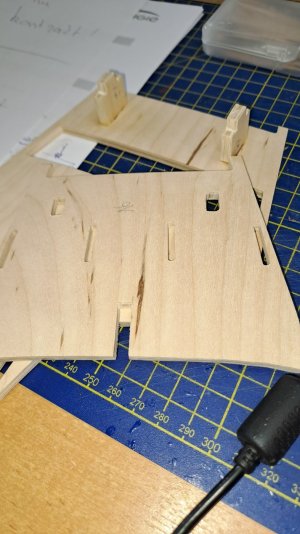

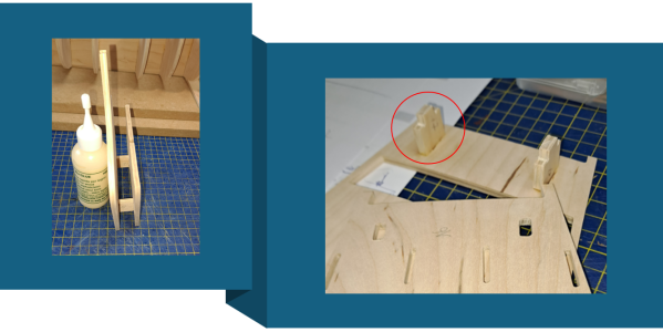

In the meantime I will try to glue the broken piece
I wouldn’t worry about that break. A modern wood glue - Tite Bond III is my current favourite - will provide a sound repair. Use some parcel tape to cover a slab of solid timber, or 25 mm mdf, or the bit of plate glass you do your sharpening on. Make another tape covered cramp pad, then lay your part on the anvil, apply glue - only enough for minimum squeeze out, carefullly cover with the pad and use a decent cramp to apply pressure, always ensuring alignment as you do so. Practice doing so dry.
Clean up once the glue has dried. I allow 24 hours.

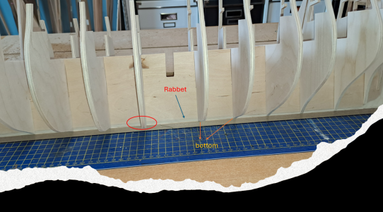

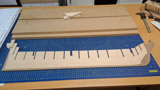

Hi Marc!

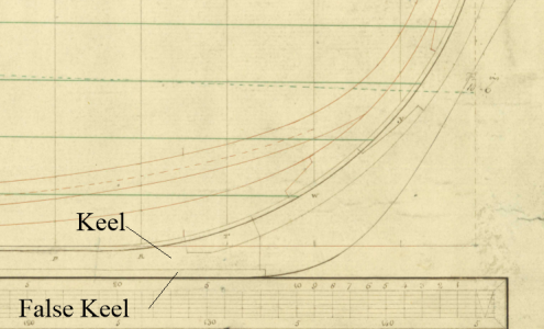

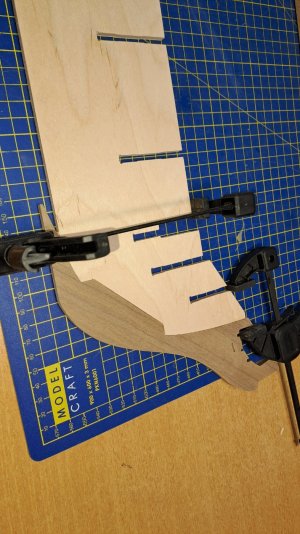

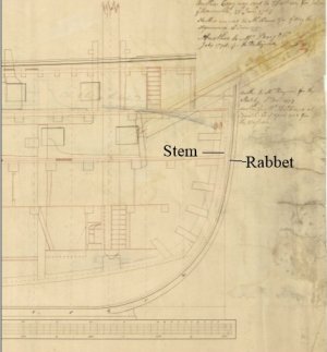

Are you forming the rabbet before gluing on the keel? Probably easier to make the varying angle of the rabbet if done before gluing to the plywood back piece. With only the knee of the head and no actual stem on the kit model, cutting the rabbet at the bow is going to be interesting :) Assuming the plans show the line of the rabbet where the stem would be, instead of tracing the line, can you scan the image in the kit? If you can, then you can print it in label paper then stick it on the wood and have a perfect curved line on the stem to cut the rabbet with a scalpel and chisels. You would need a mirror image as well for the opposite side, but easily doable. Just a thought.
Hi Marc!
Good idea
Hi Marc!

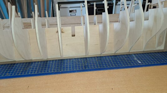

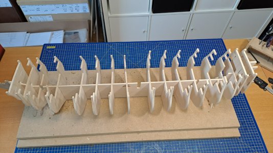

Hello Alan,
You're right (as always) :) ;)
But there is a surprise:
nowhere in the instructions nor drawings is there a reference to providing the Rabbet!
If you look at the picture of the Bulkheads (Dry Fit) you will see that the bottom side (of the Bulkheads) touch the False Keel!
So there is consequently no place for the Rabbet, unless you provide it in the False Keel. And I think this is not the intention.
Just to be on the safe side I have installed the Rabbet, above the Flase Keel so that I have the necessary flexibility during the First Planking... But still strange.

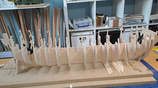

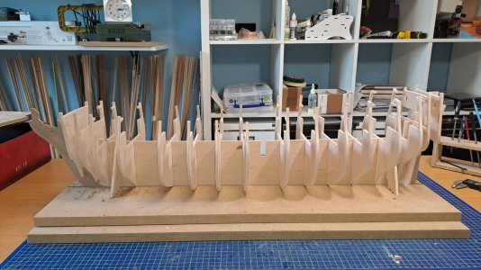

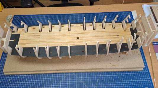

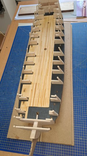

Meanwhile, the Bulkheads and the lower Gundeck have been glued....

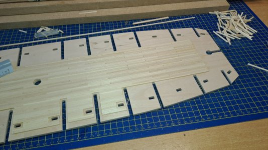

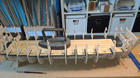

As you can see, I've covered the Lower Gun deck with Limewood strips (1x3 mm). The idea is that the deck might be visible from the higher gratings and, on the other hand, through the open gun ports. I've decided to close at least one row of the lower gun ports. I can leave the other side open as planned, but I'll evaluate this later.
I haven't seen a flat iron since my youth
