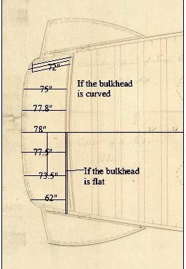

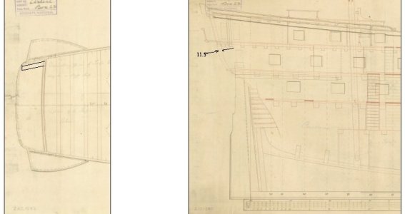

Contemporary plans for Ardent and Agamemnon

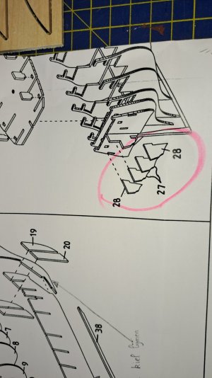

Good find Marc.SURPRISE--- important error in the drawings !!!!!!
There we go again!

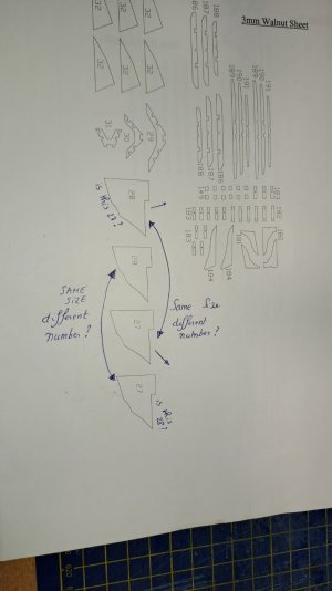

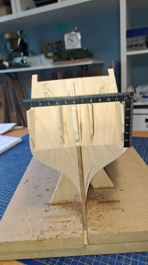

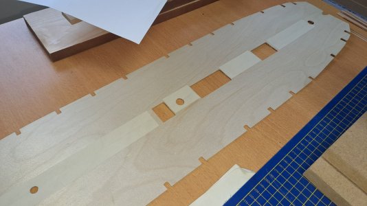

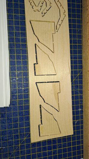

One of the next steps was gluing the Stern support frames, numbered 27 and 28 on the plan: see drawing.
If you follow the reference numbers shown on the layout plan for the basic support plywood boards, you'll be making a big mistake. There's a mismatch between numbers 27 and 28!
Numbers 27 are each the same size, but not as shown on the reference plan!
After all, the supports with number 27 are the largest and need to be glued in the center. Number 28 is on the outside and at an angle!
One 27 and one 28 are reversed!

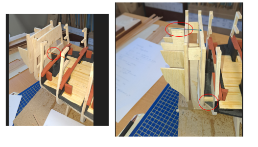

I didn't notice it at first, but if you look further at the plans, you'll see that a height difference is causing number 27 to protrude slightly beyond the other 27. I was just able to pull them out before the glue dried and figure it out!
Just like the Caldercraft Diana's building plan, there are errors again! So I've been warned and will triple-check everything!

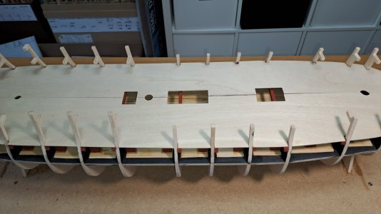

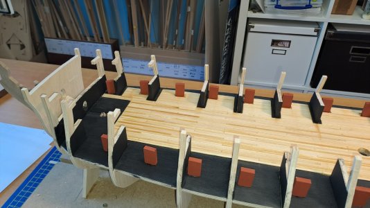

I meanwhile glued the false Gun Supports in place....
Hi MarcSURPRISE--- important error in the drawings !!!!!!
There we go again!

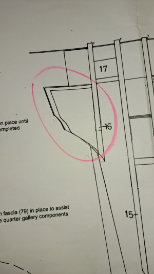

.)Unfortunately, dear Allan, this model was designed by Chris Watton again, and therefore is doomed from the start. Both several years ago and today, Chris stubbornly makes the same mistakes, and he does not even try to make his models more or less copy-like and reliable. Chris Watton has sold many of his designs to European scale model makers, he is little known in the US, but here in Europe we know his work well. He does a blatant hack job. He always has the wrong frames. He always has the wrong aft gallery windows. He always has the wrong deck heights and deck element locations.Not sure if this would be any help, but hope it does.
