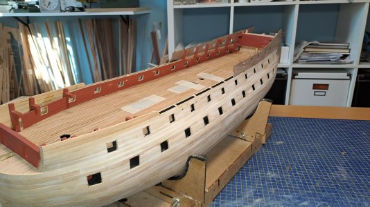

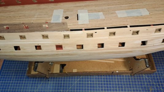

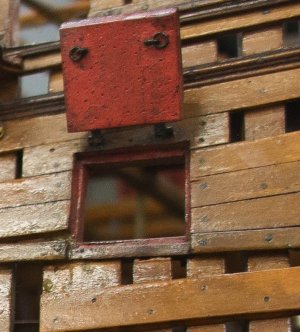

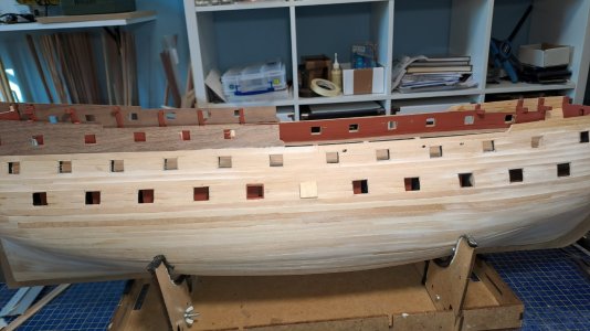

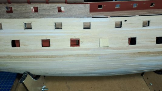

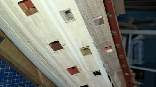

Hello!But did you measure the inside or the outside of the gunport door ?,
The openings you cut out in the hull are in the first layer of your planking...

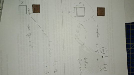

I measured the outside eg the dimensions of the GunPort Lids

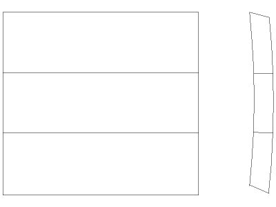

Hi, Allan!I do have a question though, how did they fay the boards together?
Many Thx for the link!I made a copy of the gunport cover, and used it as a template, to cut the gunport in the second layer.
Perhaps that explains.
As you can see in my build log.

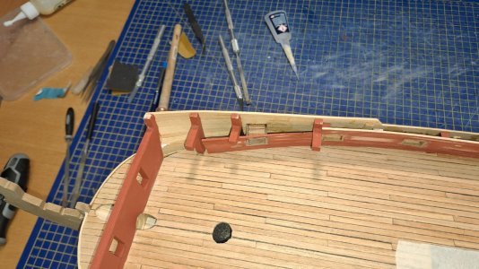

FANTASTIC BUILDThe progress of the planking...slow but I try to do my best...

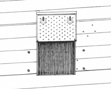

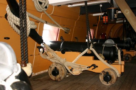

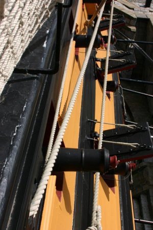

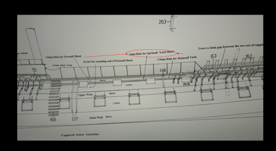

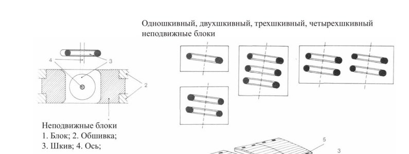

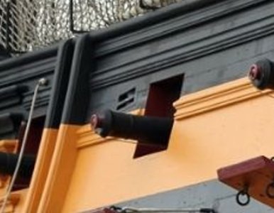

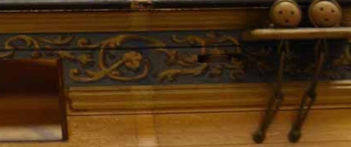

Sorry Marc, but do you mean the gun port framing, linings, gunport lids, or??How were they made in the past?

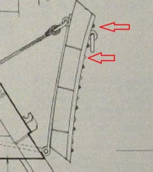

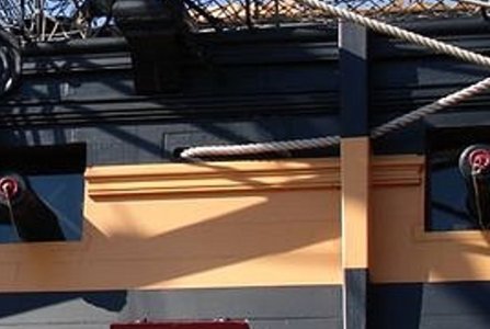

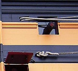

Thanks Iutar, I get it now, my mistake. There were sheaves in the hull as in your drawings for the lines mentioned to pass through, not holes. The instruction calling for holes is incorrect.I understood it this way: he is talking about the holes in the hull.
I think you have it right, although it took awhile for it to click in my mind. The openings for lines for the various tacks and sheets which run through the hull. The illustration and photos you provided are very informative.I understood it this way: he is talking about the holes in the hull.
The last line of the text.
Hi Allan,Thanks Iutar, I get it now, my mistake. There were sheaves in the hull as in your drawings for the lines mentioned to pass through, not holes. The instruction calling for holes is incorrect.
