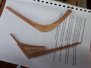

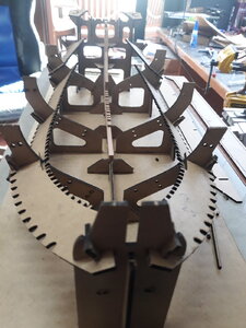

The build has started with the cradle almost complete and the keel, sternpost etc underway... Some lousy photos are attached.. Now for those not yet started their Alert be advised that there are some tight fits as regards tabs and slots.. This I reckon is not from inaccuracy, but from fantastically close tolerances.It is amazing work from Trident..
.The instructions are a bit ropey but hey, don't ask me to translate a technical document into another language...
When looking at the skeleton like cradle one is astonished at the attention to detail in the cradle itself...

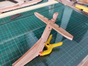

O.K. I'll blink first...My log will be delayed for a short while... It appears that I have completely ballsed up the stern and the bow...Somehow, probably through my interpretation of the instructions and the drawings , several parts did not or would not fit as expected..I have had to resort to hacking certain portions of the cradle and referring to the plans and the AOTS to make adjustments to allow fitting of various timbers.
The end result will still of course deliver the Alert as the plans indicated.

By the way ,the frames are going together really well and the rest of the construction should be fairly straight foward.

Hi Brian, I hear what you say, but it seems to revolve around the cradle part C16 C17 and their relationship with Bl30 etc.
I'm not particularly worried about it.. I will just do things a little differently than the instructions.

I have followed Trident's instructions very closely and I recommend other participants do the same..It's just when I get to assembling the stern pieces and in particular the parts using C 16 and 17 as the jig that the fun begins.I would suggest as always that one should dry fit the relevant part and in this case dry fit parts that are adjacent to or part of the next process.
Gee I hope I am explaining this properly... another way of saying it would be
Don't only dry fit the part in question but also dry fit any adjoining part or
parts that will be fitted in subsequent actions.

Yeah, the cradle is quite a tight fit but it does fit after a bit of sanding of the char..Keel went together quite ok .I'm referring to the stern post and part bl30 and surrounding parts.
