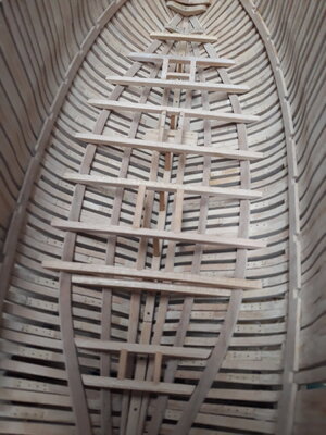

An update.. The beams etc for the lower deck have been dry fitted pending a decision regarding the installation or otherwise of the interior cabins and other spaces. I'm reasonably happy with them.

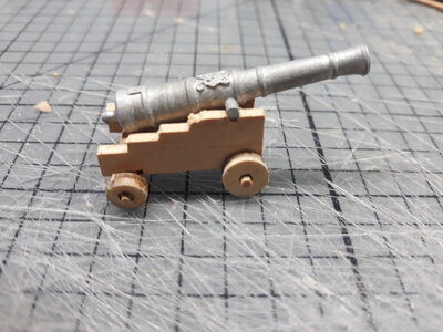

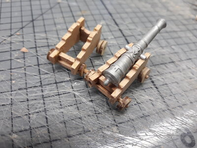

Just for a change I started to assemble a couple of the canons.
What a job...completed and in the right hands they are probably quite good but when you're as cack-handed as I am it is a challenge!!I've shown a couple of the partially built carriages. Have look at the component pieces on the instruction booklet and then look at the pieces themselves on their respective sheets.
Hello Daniel! With the beams dry fitted it does look great, I just said, WOW!! Very accurate\clean assembly. The beams find their places with no gaps. Certainly, we would like more photos!!
What are the challenges when you assemble the cannon carriages? In the photo, they look OK. With the scale they are, we can 'dress them up' e.g. add more details, I think. But, it is a personal decision and a matter of taste ;)

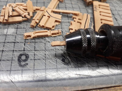

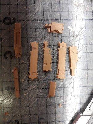

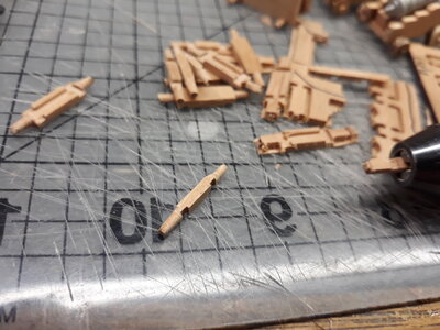

Now about those cannon carriages...I've taken a couple of shots(pun intended) of some of the parts.
In one photo you can see the main pieces i.e. The four parts that make up the carriage cheeks and the two axles along with the fore and aft "spacing' pieces. All are as rough cut from their respective sheets.
I sand the axles down to a recognisable level and place them one at a time in my Dremel chuck.I then turn the axle at moderate speed and work the square end of the axle into something resembling "round" to accept the truck. A lot more detail to be added of course.20201028_153344[1].jpg20201028_154357[1].jpg20201028_153358[1].jpg
