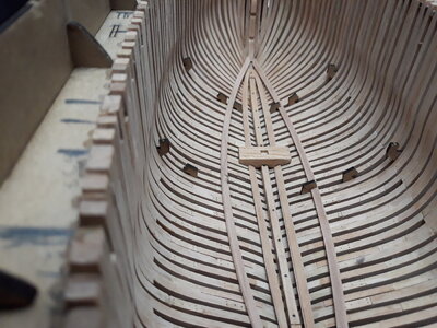

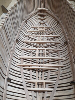

Paul ,Fun I have not had today.. Didn't get to do any of the aforementioned...I laid the keelson and the limber strakes. Along with those hooky looking bits of mdf designed to assist in the run of the deck clamps.
Oh ,boy!!!!Any way after much fidding and fitting they're in ,but the limber strakes etc. are a temp. fit.
The joints in my fingers and hand are quite tired.
I have decided to use the "track pins" to represent the major bolts along the keelson etc. I am not going to overdo it 'cause I don't want it to look "freckly".
Anyway.. back to it. Cheers, Dan w

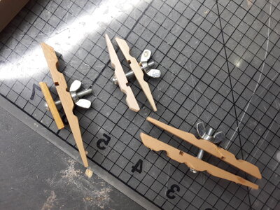

But seriously, I know the Homemade device pictured has been around for ages,but I thought I'd remind everyone of the endless combinations that can be made.
Very handy indeed.Old fashioned wooden clothes pegs available at the "two dollar shop"for very cheap..20201006_092122[1].jpg20201006_092056[1].jpg

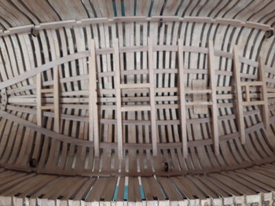

Thanks, John, It is a buzz(relief) to see all those ribs lined up...But there is always that little niggling thought,"Gee I could have done that bit better". But if one thinks like that all the time one would go crazy..
Hey Jim, you must have been typing as I was replying to John.
I suppose the initial burst of activity is driven by wanting to see how this "thing" is going to shape up...
I continue to amazed at the thought that has gone into some of the small details on this project , for example the various templates and jigs..Quite clever.

I may be getting a bit ahead of myself here or I may have made a huge stuff up.It concerns the Limber strakes and deck clamps that lie longitudinally along the hull.(part no.DL1 DL2 DL30 and parts BL25 BL26 BL27, Breast hooks). It would seem that the cut outs in the breast hooks bear little or no resemblance to the dimensions of DL1 DL2 orDL30.If anyone gets a chance could you have a look and see what is wrong? If it's me I will cop the raucous laughter and derisive comments!:confused:
Cheers Dan w

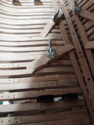

I have dry fitted the lower deck beams etc. They require fine sanding and removal of pencil marks as well as proper alignment.
Be sure to soak the deck clamps before attempting to fit them.
Wang' s contribution has been invaluable and I am looking fwd to Trident's details re the interior . 20201013_073834[1].jpg20201013_073755[1].jpg
