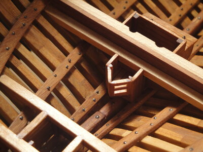

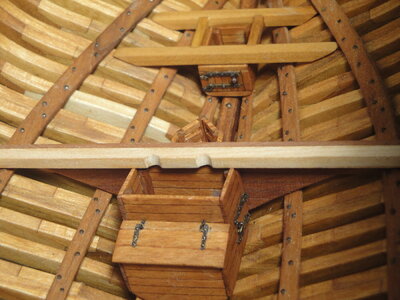

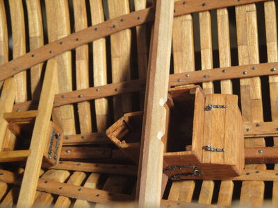

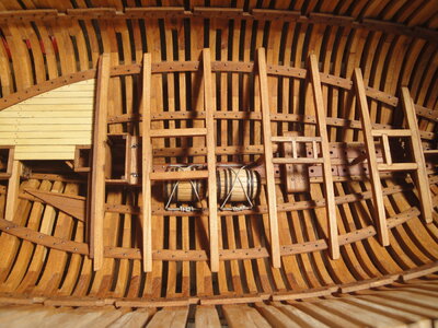

Hallo everybody. Thanks for Your comments and likes. I started with the construction of the pump well and powder room area.DSC01950.JPGDSC01965.JPGDSC01958.JPGDSC01960.JPGDSC01963.JPG

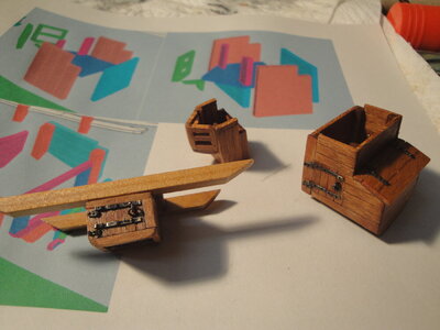

Little side project: the barrel (one of the two provided by Trident Model).DSC01971.JPG

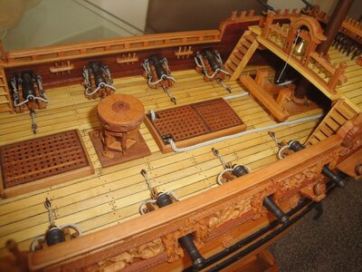

On one of my last models, Royal Caroline, the decks were made from boxwood.

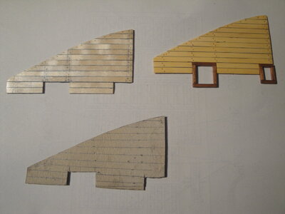

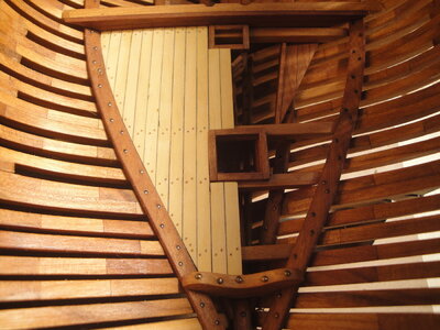

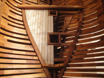

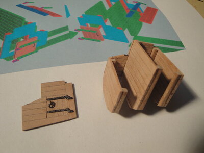

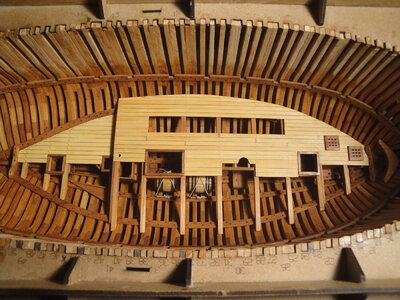

Hallo everybody. Thanks for Your comments and likes. Boxwood or maple that is the question? In order to find out the answer I prepared two small decks above the powder room from both of them.DSC01975.JPGDSC01977.JPGDSC01986.JPGDSC01987.JPG
After comparing both solutions, I identified a clear favourite for myself. What do You think about it?
Greetings
PeterM
Definitely maple. The grain is much smaller, and the yellow color blends in better with the surrounding model since it doesn't have the weathered, worn appearance of the boxwood. The rest of the model has a new-made, abstract appearance. The boxwood deck would suit a model that is aimed at a weathered realistic appearance that would include black stains, graying aged wood, and more texture in the wood.
Definitely, the boxwood for my taste (I assume it is the first image when installed), a uniform, and absolutely no grain shown...and treenails are a perfect match. It is really in harmony with cherry frames.
Hallo everybody. Thanks for Your opinions. Yes, boxwood is the yellow one (after beeing covered with varnish) and the weathered white/gray sample is maple. So, everybody finds boxwood a better solution and it is also my favourite and the decks will be made from boxwood. Thanks for Your help.
Greetings
PeterM

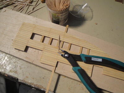

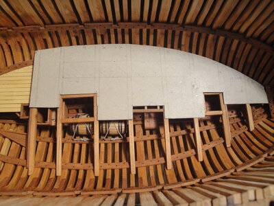

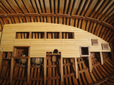

Hallo everybody. I prepeared a template for the main lower deck. It is easier for me to construct the deck outside the ship and install it inside afterwards. You have a better access to the surface in order to sand and polish it. It is also easier to nail the planks to the deck. I use toothpicks for the nails, the holes are 0,6mm in diameter.DSC01991.JPGDSC01992.JPGDSC01997.JPGDSC01998.JPGDSC01999.JPG
I think that it was a good decision to choose boxwood for the deck planks.
Greetings
PeterM
