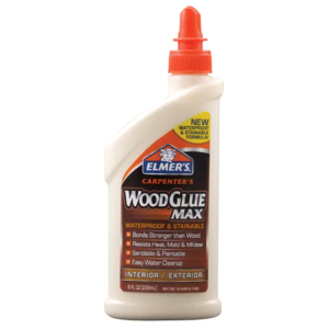

Great to know that Paul that you were able to fix! Personally, I know how frustrated it could be...I use Elmer's Max glue for framing assembly and happy. I was able to test the stronghold: One of the floor timbers (frame 55) was wrong for that frame, and when I dry-fitted it broke...but chocks were in place. When I try to remove chocks from broken pieces - no avail, I took from spare... Trident Studion supplied spare chocks. (very nice).

Paul, Re the stern sections.. I told ya so..;). I don't know what the Elmer's glue is that Jimsky uses.. If it is a PVA then Isopropyl Alcohol will soften the PVA allowing the joint to be disassembled. If it is a CA(super glue) derivative then Acetone will do the same.
Elmers is just a brand of strong PVA wood glue with a slight yellow occre tinge like liquid nails.I Bunings used to stock, but they have a Gorilla wood glue that is similar. Most of the Exterior wood glues are like that. I always used the Cheap interior dry clear Selleys Aquadhere. or for Matt Dry Modpodge ( from Spotlight craft section) as a sealer.
2 THINGS GUYS HAVE SAID IT SO MANY TIMES IT IS GETTING OLD KEEP FIXING BREAKING PARTS SPENDING TIME OR DO 2 THINGS, ONE ON ANY TYPE OF GLUE PVA, OR CA, OR NO MATTER HOW LONG USE NAIL POLIS REMOVER MUST BE 100% ACATON CAREEFULL BRUSH ON THE JOIN START PRYING SLOWLY IT WILL COME APART WITH NO DAMAGE NO GLUE RESIDUE, 2 USE WELL BOND GLUE IT IS A PVA, USE 99% RUBBING ALCHOL, IN A SHORT TIME YOU CAN TAKE IT APART, THE END. GOD BLESS STAY SAFE ALL DON
Hello Dan,
I am using Elmer's Wood glue MAX. It based PVA for sure and holds very strong. It dryes clear.
Very happy with it.
