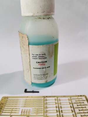

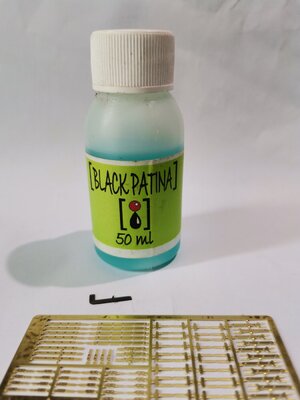

The product is regularly used to blacken brass, copper, pewter to a dark gray color. I have used it for a long time and had no issues before on PE, copper eyelets, brass nails etc. I dilute at 1:10 with water. The parts are swished around in the solution till they go dark - Normally this is not very long. At the same time the liquid goes from clear to a dark blue in color. This suggests the liquid is based on a copper sulphate solution
In this instance there was no change in the liquid color. However the PE darkened. When I washed the parts in cold water, the dark areas started to wash off also and the parts became very brittle. They did not melt, but became hard and snapped at the lightest touch.
I have never seen this before. I can only assume that the PE is not just brass but some other alloy. Brass black is regularly used in the model ship industry.

Sorry about the bad luck Paul.

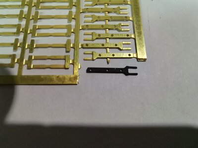

I tested a 'sacrificial' piece in a blackening solution I got from my local art supply store(used mainly by the leaded glass people and dirt cheap, $0.5 per 50ml)
Also diluted to about 10:1 with water and I left the piece in for about 10 minutes.
The results were a bit more encouraging :) Blackened nicely and no disintegration
Main ingredient is nitric acid

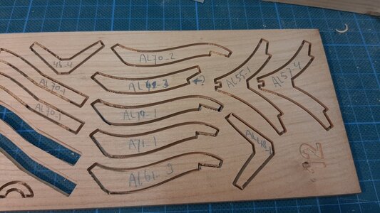

HI Zoltan. There is no mismatch with parts. Board 12 is laid out differently than shown in manual. From the right hand side near the no 12 the order of the parts are from top to bottom 70, 63( duplicate) 70,71,71 not 70,70,71,71 63. It is obvious that 63 is in a diffrent position.
Thank you Paul!
