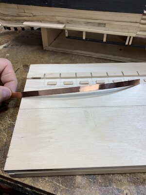

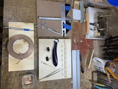

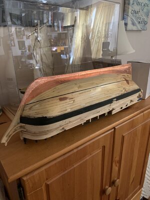

Doing the copper plates on the hull. very time consuming and intense.. but worth it when done. I built a jig to put the nails in and a ponce wheel to do it. then i cut the strip into 4 plate segments and attached to the hull
