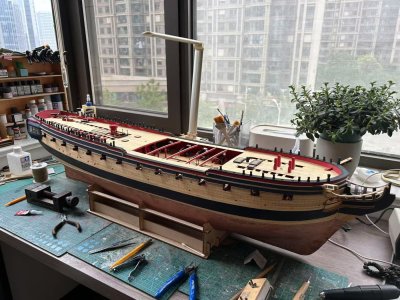

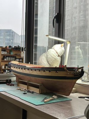

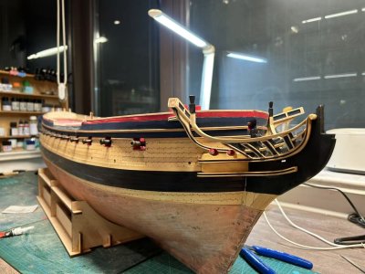

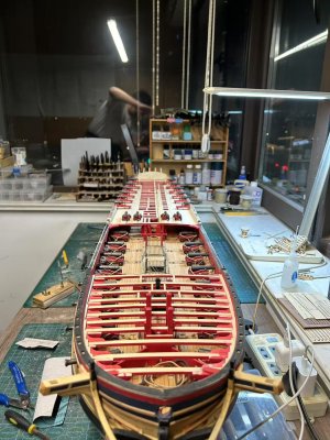

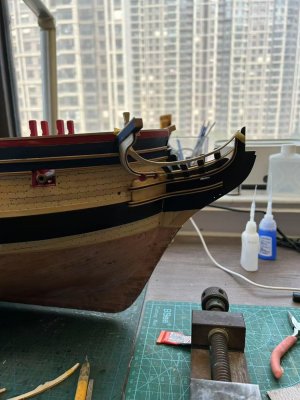

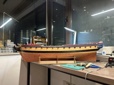

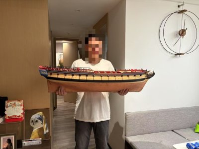

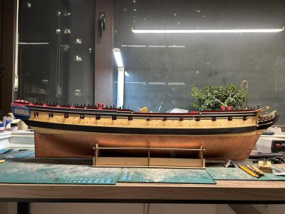

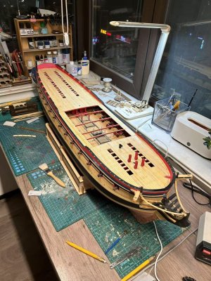

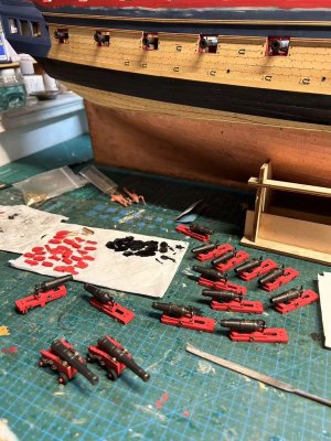

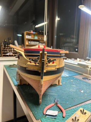

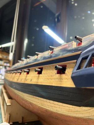

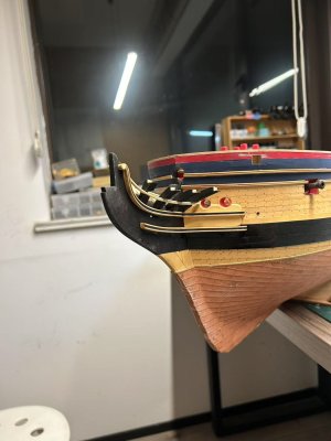

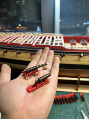

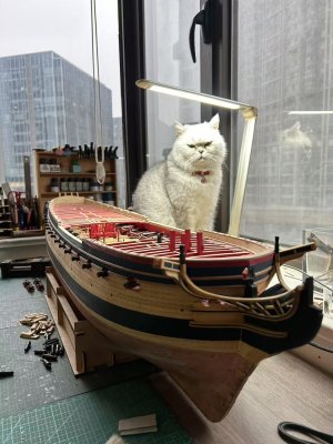

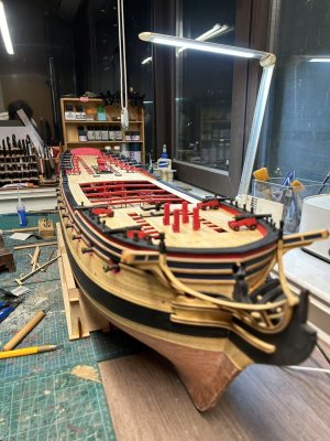

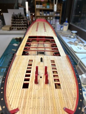

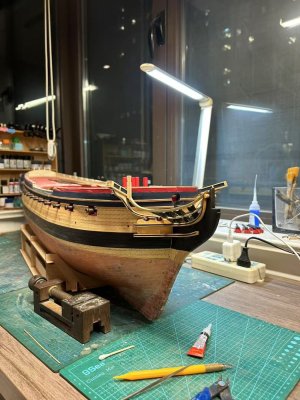

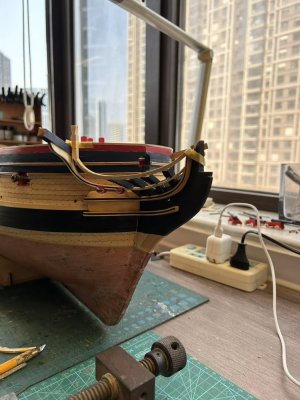

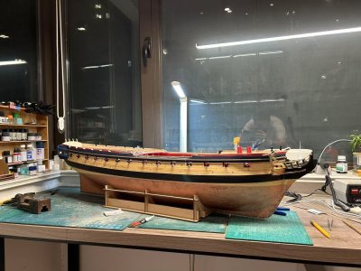

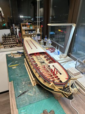

The progress continues. The design of the gun deck of this ship is very restored. I even doubt whether it is necessary to restore it in this way, which will extend the production time.
The designer's logic is to keep the invisible parts as simple as possible and easy to make. The visible parts should be restored as much as possible to enrich the details.
This ship is currently verified and produced. As the first producer, I have been communicating with the designer and provided production feedback in time. I will accelerate the production later, and complete the production of the upper deck and the hull as soon as possible, including carving installation

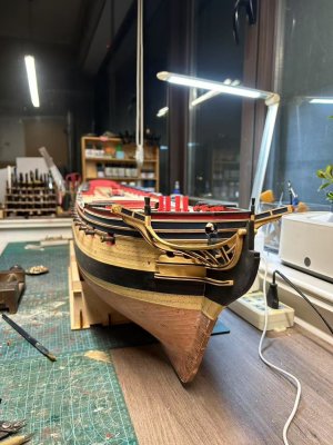

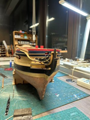

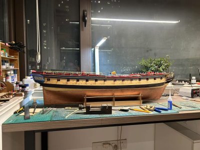

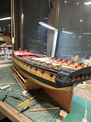

Excellent work. I like it. neat and precise everything. One piece of advice, how to finish the process when you don't need to take the model in your hands - use a copper cleaner to remove fingerprints and stains. (first try it on a sample). This way the surface will be uniform and will darken evenly.
Very useful proposal, but too late for meCautiousCautiousI've already applied a layer of protective paint
