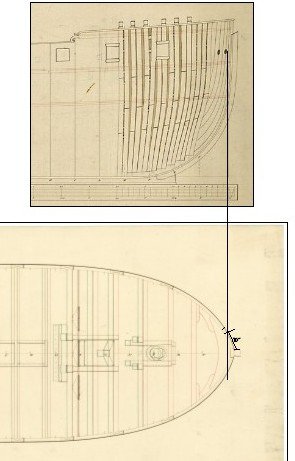

I've not put in the holes yet (as I've not got the hawse timbers fully assembled). The positioning is not too hard to get since they are shown on the side view. Plus the note from Allan provided information that there is almost 12 inches between the holes. However, I don't have information to show how far out from the stem is the first hole.
I messed with low res drawings of Enterprise and came up with the inboard most hole inboard edge as 40 inches from the stem, but this could very well be off a bit working with low res plans.
