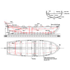

Sorry for not explaining the parts better for anyone not yet familiar. The below is a single banked launch, but might be useful regarding terminology and parts found on boats. There were variations in size, style of gunwale, and more, but most of the basics are shown.
Tolle Illustration, Allan. Ich wette, alle Neulinge wurden auf die dritte Ruderbank eingeteilt und stießen mit den Knien gegen die Ankerwinde.
How right you are, Russ! It's normal for all beginners in the navy to have to earn their sailor's boots first. In other words, all the hard and unpleasant work had to be done by the (novice) sailors first. But if you persevered, you later earned a place among the sailors and could then look down on the other beginners!

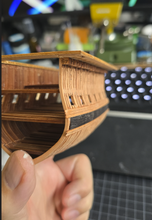

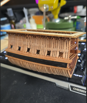

So, here's another little step forward with my Enterprise. :D

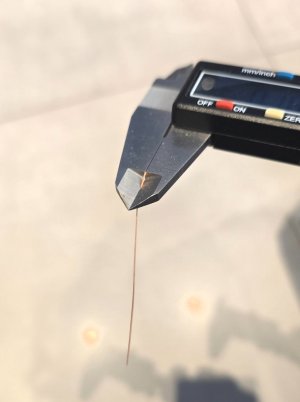

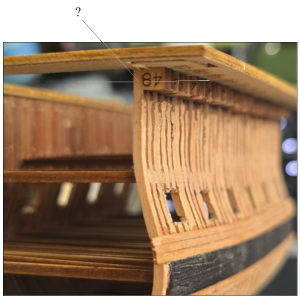

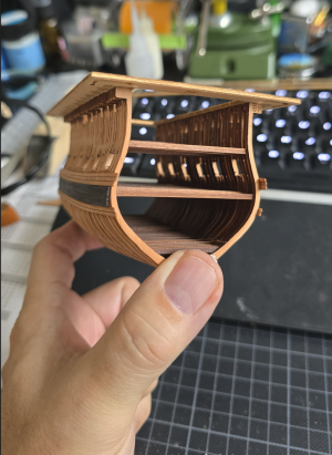

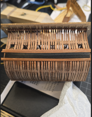

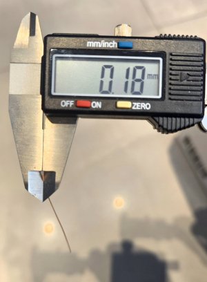

As you know, I unfortunately made a construction error because I mixed up the frames for the gun ports. That meant I had to make the notches for the gun ports myself. To do that, I needed the exact dimensions for the gun ports. Luckily, Richard is also building the middle section of the HMS Enterprise and is further along than I am in my build report. He was kind enough to give me the exact measurements: H 4.7 mm and W 5.8 mm. I transferred the measurements to my frames and cut and sanded them out. I have also already attached the butt planking. Everything has yet to be sanded and polished, but that will come. I will also soon be finished with the small dinghy. I now have to glue the planks in place. To do this, I sanded the planks down to 0.18 mm. What madness... Of course, two planks broke again...
As always, here are a few pictures of my construction progress, and I hope you like them.

I have a question about the cutter. How did you attach the planks? It looks like my only option is to attach the planks to the bow and stern, as that's where the raised areas are and where I can glue the planks down. But what about the hull itself? I don't know how to glue them down there. At most, I could attach small pieces of wood, which I could then use as a surface for gluing. What do you think?
P.S.: I hope you understand what I mean. Please excuse my poor English. I have to rely on English translators.
Your English is excellent Gunther,
I haven't attached the planks yet. I considered extending some frames as a support and steaming the planks, but am not really sure?
Oh, I'm glad you understand me. That makes me very happy. :D Thumbsup
You can see that we are both concerned about the same problem.:confused: Unfortunately, there is nothing about it in the instructions. That's why I'm really wondering how the planks were attached... I'm also thinking about something...Explosion

Thank you for your encouragement. :D Yes, the gun ports look good now. Unfortunately, my construction error cost me time. But that's just how it is.;)
As they say, mistakes are not forgiven, but noticed until they are corrected... Thank you for your trust, and I am sure this kit is full of little challenges...

That must be a big relief that you got the gunport made and in line, Günther. They look nice.
