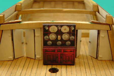

'Glimpse' of the Welsh Dresser through the Coach Cabin door

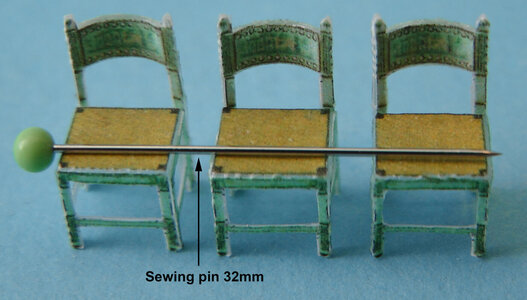

In my, HMS Fly build I have incorporated the Great Cabin, Stateroom, and Coach Cabin, and into each of these cabins I have constructed 1:64 scale furniture using acetate film, and a combination of Paint Shop Pro graphic design and origami with a plastic film.
A sharp craft knife and good eyesight are essential and lots of patience. I have made 9 pieces of furniture for the three cabins and this has taken me 2 years, and the irony is they will only really be seen by “God”!

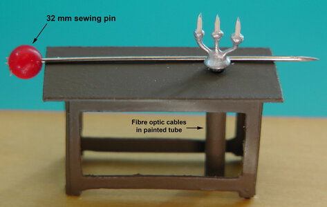

I have attached a photo of the Table which will be eventually fitted into the Great Cabin, and on it can be seen a three-candle stand. These candles are lit and flicker, and this is done with Fibre Optics; they will be seen through the Great Cabin windows.
The chairs are 1:64 scale replicas of a set owned by Lord Nelson, and this is a good example of how using a graphic design package can give a different perspective to modeling. My wife and I went to see the actual chair at the Royal Maritime Museum Greenwich, London, so the dimensions would be correct.
Whilst the items may look difficult to make, they are in fact relatively easy to construct, but has previously said a lot of patience is required. I think most members have this, and some of the models I have seen on this forum are superb!
Please contact me if further information is required; I have made a Sea Chest and Bureau for the Great Cabin, Sea Cot and Wash Basin for the Stateroom, and a Welsh Dresser, Table, and four Chairs for the Coach Cabin.
