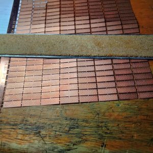

So far I have the first sheet cut apart and have started cutting off the nibs.IMG20250721125734.jpg

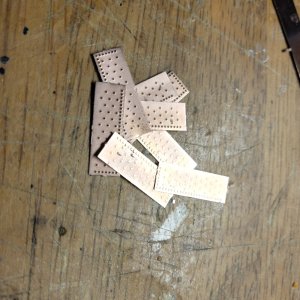

I finally finished trimming the copper plates. Initially I was using a #11 xacto blade to cut them out. I the. Started using a pair of kitchen shears. Finally I transitioned to a small pair of sewing scissors. I found that if I placed the copper plates tight to the scissors and up against the area they be trimmed that if I just barely started cutting the nib and pushes lightly forward at the same time; I got a flat cut that didn't bend the plate. In fact, it became easy to get a neatly trimmed plate without bending or distortion.
I hope that explanation is good enough to follow because the difference in effort and results were surprisingly good.
The final technique was approximately 6-8 time faster than the xacto blade.

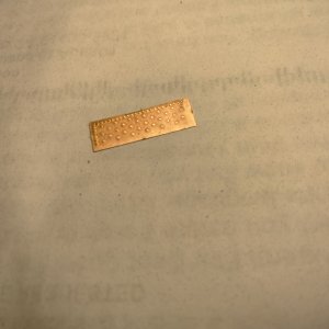

The new copper plates have two blank edges without nail patterns.
On the other side I was able to install them like bricks but these will have to be overlapped.

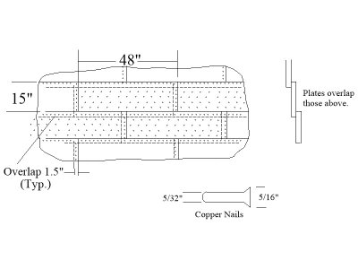

The plans in my photo show using a 6mm dowel but show the spar at 6.02 after the flats are cut. The flat portion on the plans is 3.04mm.

Four plates in place. It's definitely a lot more difficult to overlap the plates. I have trouble keeping them aligned without using using CA glue to anchor them while the Super Phatic glue sets. I hope I don't have a problem keeping the spacing consistent since I don't have a mark to judge the overlap.IMG20250726090156.jpg

Love it. Great to see it being done this way. Looks like the material is very thin so the overlap looks really nice. Something to consider is that the overlap on the long edge needs to have the plates start at the waterline, not at the keel. In the end I doubt many people will notice.
Thanks. I understand that but half of the plates I received have to go from bottom up to keep the overlap from keel to waterline.
I'll restart at the top and work it out later
I started again at the waterline. I don't know why but it's easier going in this direction.View attachment 534496
