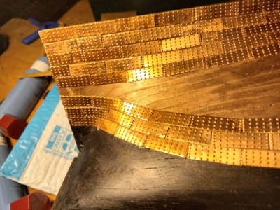

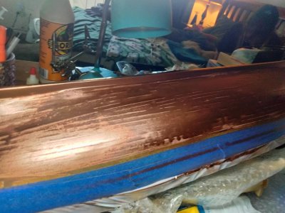

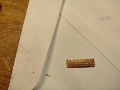

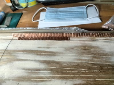

Well, that's one way to do it. You may find that you now have more adhesion problems than you did before. Before you commit to the hull, might I suggest a test by prepping a piece of scrap the same way you did your hull and spraying it also. Make sure it has had plenty of time to dry. Then try gluing some extra plates to it and see how they hold.

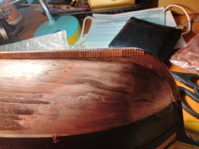

They seem to be holding better. I'm using more glue and got out a new bottle of CA.

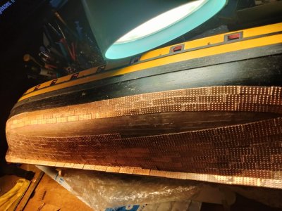

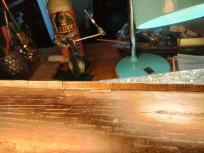

The first row of the belt plates is complete. Much easier View attachment 527754

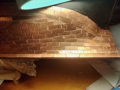

Ted, Just my opinion if you are going to have 3 rows on your "belt"I would not do the 3rd row until the rest of the hull has its plates in place. This would make it easier to trim and overlap the belt rows with the other rows and perhaps make things easier and neater.
Rob
Rob

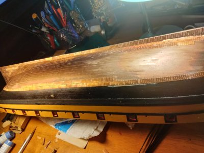

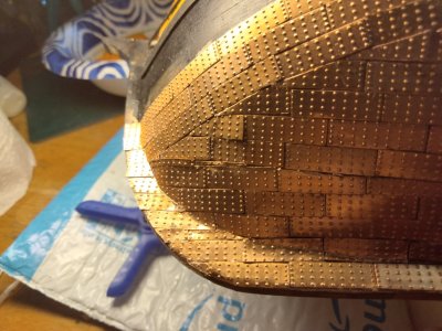

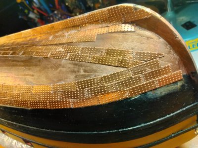

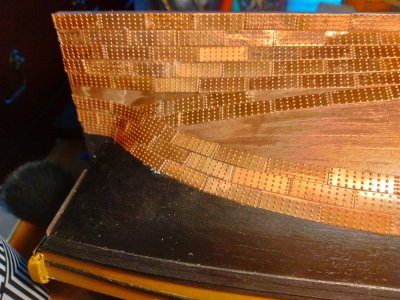

Here is the fire portion of the copper plates.
A little raggedy but I'm already afraid I don't have enough to finish the second side and my kit manufacturer doesn't respond to any attempts to contact them.

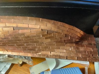

I have four little sections to do ai the stern and will be able to count out if I have enough plates. This light angle really shows the roughness vs the last oho with normal lighting17515567016041984977176514571810.jpg
I finally found a phone number for the Caldercraft rep here in America.
Of course they don't sell the copper plates. He recommended Model Ship ways. Way too expensive. $18 plus tax and shipping for 50 plates.
Researching alternatives
Ted! The gore lines look excellent! I'm sorry you ran out of plates but pleased you found a good source for replacements! She's coming right along! Keep of the good work, sir!

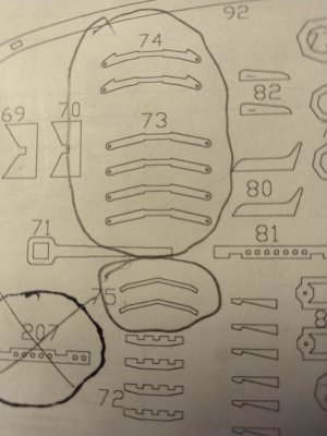

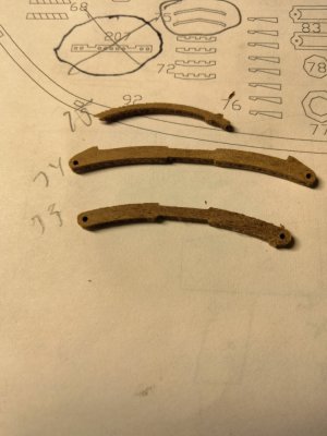

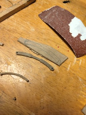

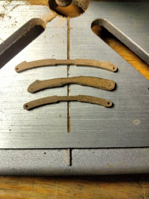

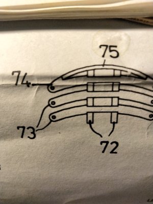

I've been trying to make new part 74 in the correct length. So far I've made a few buy wasn't satisfied with the quality.
It just occurred to me to cut down the too wide parts.
In the photos-
Top is provided part 74
Middle is my latest, in process,attempt to make one.
