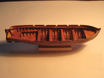

So it’s been a crazy couple of weeks but I haven’t been idle on the Mercury. Shipyard don’t include any ship’s boats in the laser cut kit. I do find this a little strange as their smaller paper kit does include them.
I sourced 1/72 scale Launch, pinnace, cutter and yawl wooden kits which come quite detailed out of company from China. These are the four boat set for a kit of the HMS Surprise, so perfect I thought for Mercury.
All parts a laser cut, though fragile so a new sharp blade was used. I won’t write much about the build up as the photos should make it quite clear. CE34D399-3D9C-427D-B3A9-F8348B6BBC71.jpeg1CC8BDCC-0E0B-4B16-B300-34AFF861096B.jpegAF7D1C17-6862-4298-827E-D7EAD76C863D.jpegD9712C88-9700-4077-A82F-FA98E3B2C0B9.jpegEAFD141F-6155-4C7F-9182-C51FE7FE0ACC.jpegD944B671-9783-4089-A8D0-D67AB940BF44.jpegB854EF54-664E-4E1B-9BC3-B7CAA97DCB3B.jpeg0CD90F2B-2575-4950-9B6B-D317A31AAC0F.jpegFFC4E042-D69D-42F5-8AD8-90D4D10A694E.jpeg63258A45-3AAD-4E4F-907B-AAA6AAC11D71.jpegDD5EF14F-4C33-4674-9F26-4272488CA186.jpeg71BC15BB-FB41-4179-B0D5-653599B7F941.jpeg

The Jolly boat now made up. This was and is the most difficult of the four boats, not only being the smallest but due to the rather blunt bow and curved stern, require quite a bit of plank bending. 3522EF49-2C49-4226-9C55-3F7285E60975.jpeg3CE00ACB-0F3D-4652-A546-F9067FEEF6ED.jpeg351A56B9-41FB-4ADD-A36A-9911B917B672.jpeg4B413D6C-FBD2-46B0-B411-A8EFFF845093.jpeg464DF333-24FA-4247-9B8D-B4C4874F5F5D.jpeg66943676-1FB4-48D4-A230-D3D5E51A9AD7.jpeg

The small boats are a ship building project in themselves.
That they are, and a nice break from making all the blocks!
