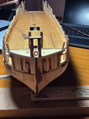

I think it looks great. I found this build frustrating put mine aside for a while.

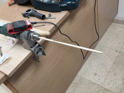

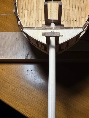

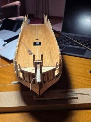

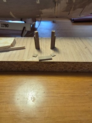

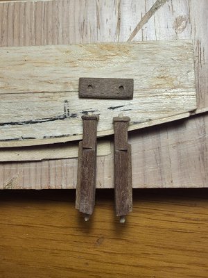

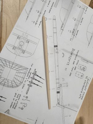

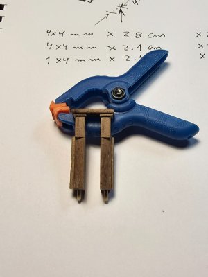

Hi!
While the above discussion is going on, my build is also progressing.
I finished opening the ports and doors on the internal planking.
Next step will be to carve the dowel of the bowsprit to the appropriate shape, on the part that will lie inside the bow and build and install the Hbow bitts, to which planking will be applied.
Then, an opening will have to be drilled on the bow for receiving the bowsprit.
The bowsprit will sit on the bowsprit bitts, which are already built (see photos below.
This will keep me occupied for the next week.
Best regards
Catela

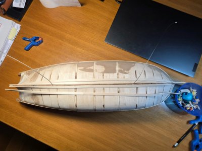

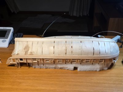

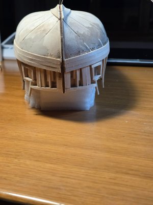

I started planking my Ontario.
Up to now I installed the three main wales, the garboard and the broad strake.
To bend the strips I soak them in water and leave them to dry fitted, as best as possible, to the hull.
When dry, they keep the shape quite well as can be seen in the following photo. I make final adjustments and glue it in the same position they were left to dry.
This method produced acceptable results in my first model.
Marisstella recomends to make scarphed joints on the wales, but says nothing about the garboard and broad strake.
This raised a question for which I would like to have your opinion: Should all planks joints be scarphed, or only the "main" ones (wales, garboard and broad strake?
The wales already installed will be covered by a second layer of planks.
The two boards next to the keel will have to be carved to fake the scarphed joint, if needed (don't no if I will risk to do that...)
Another question I have is: how were the planks secured to the bulkheads? With iron/steel nails? With treenails?
I've seen models where treenails are applied to the hull. Marisstella gives no such instruction. Or perhaps they assume the modeler should have the required experience and don't mention those details at all. in the instructions
This model will have almost no bare wood visible. Everything will be painted, and the joints and treenails more or less covered anyway!
Looking forward to get your opinions and recommendations.
Best regards
Catela
Thank you for your question. In the historical construction of the actual ship, planks were typically secured using treenails (wooden pegs). However, please note that this model kit does not include or require treenails for assembly. The included instructions will guide you on the appropriate assembly method for the model.
Let us know if you have any other questions.
