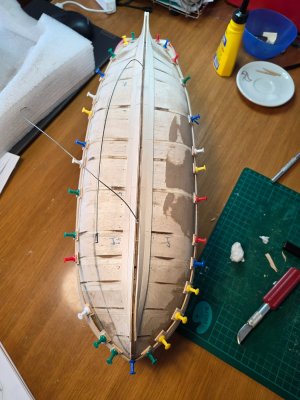

Hi there,

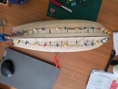

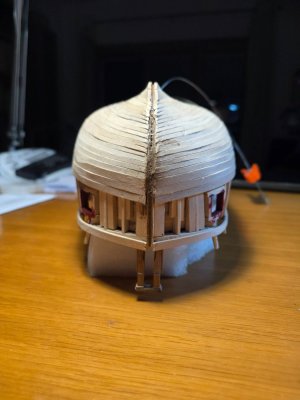

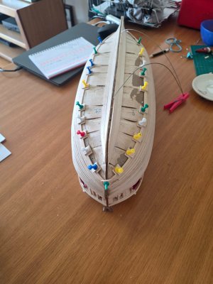

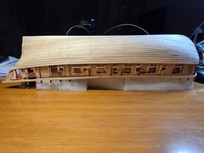

I've been busy with my hull planking.
It's coming along, but not without some self complaints.

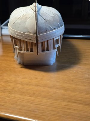

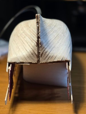

The flow of the planks is not as good as I would have liked it to be, as can be seen in the last picture of this post.

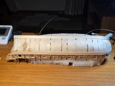

The main wales (which will get a second planking layer) are installed. These strakes were not tapered.

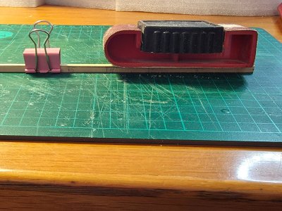

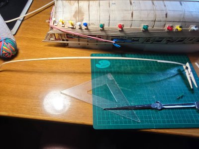

The other planks wer tapered. I do it two by two, by sanding them down to desired width.

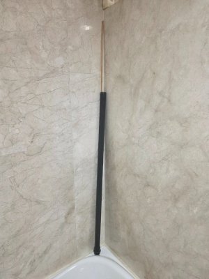

To bend the strakes to the hull shape, I soak them in water (I use a PVC pipe filled with water for this purpose) and leave them to dry attached to the model.

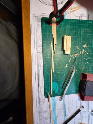

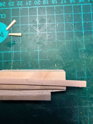

According to Marisstella, some plank strakes should have scarffed joints, instead of butt joints.
My maine issue with these joints is how to guarantee uniform dimensions and look for all joints.
So, I made a small jig to facilitate the cut of the joint.
The jig, and the resulting scarffed strake before being glued one plank to another and the set being glued to the hull.

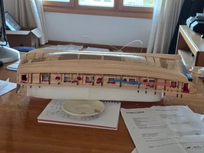

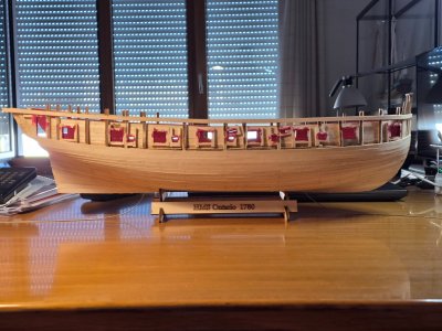

Planking as of today:

Hi there,
View attachment 602773View attachment 602774
View attachment 602778View attachment 602776View attachment 602775
View attachment 602779View attachment 602780

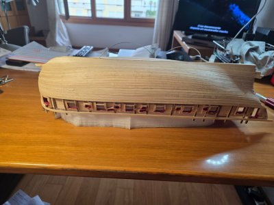

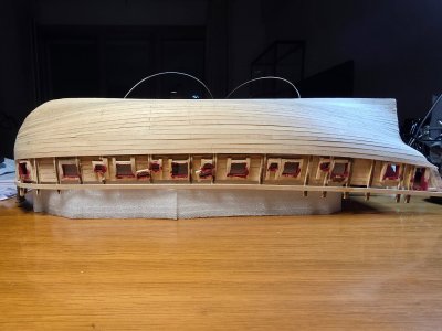

Best regards,
Catela
Good morning Catela. I like the scarf joint- nice. Planking looking good so far. Cheers Grant
