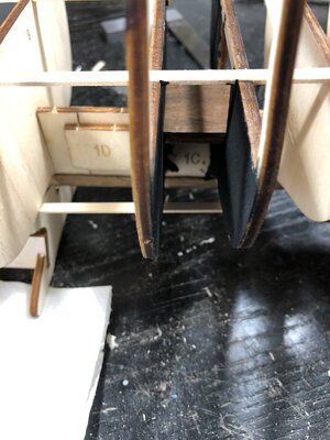

So here pay attention to piece 7.1, take note of the planking that needs to be added to the top of it. I did not take note of this and had to plank it when it was glued into position.
And here it is planked and looking not too bad, right? NOT. It needs to be taken out and moved ahead one bulkhead further forward. Had I noticed this beforehand the planking would have been much easier!!!
Here it is in the proper place, at least now the future ladder will have a place to rest.

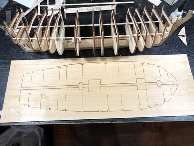

Next is the false floor, this is a sheet of solid wood that is pre-cut. I am not sure what the slits are for but I'm thinking it is to help with the bending required to get them into place.
These last pictures are showing the dry fitting. The pieces need to be slid in from the rear, under all the bulkhead tops. A little fine tuning was required but nothing serious.
