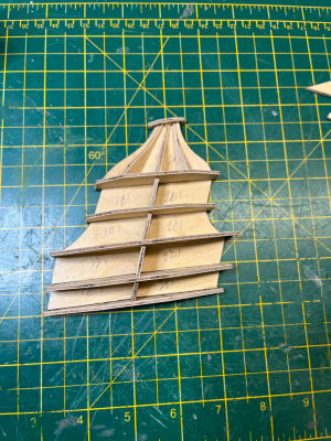

OK, I am back to working on my build. I just finished the first layer of planking which I have been doing for several months. This hull is huge and complicated. Because this model has three times the number of bulkheads as most kits, it took a whole lot of adjusting to get them square enough to plank. It is not perfect but pretty good. I have filled in some spots with filler to smooth it out in preparation for the second finish layer of planking which will be applied later on. I am going to mark and cut out all of the gun ports before doing anything else. It was necessary to place the base of the exposed main deck in order locate the exposed guns and align them with the run of the whole deck. It was necessary to cut the deck in half and remove the tabs along the sides in order to get it in place between the many bulkheads. The overhang of the upper decks made in impossible to fit the deck in one piece. Once the deck is planked the seam will be covered up.
My daughter has a commercial laser cutter and made me frames for all of the gun port cut outs. I used some to make a jig for marking them on the hull and then cutting them out later on.
VinceP Ship-1

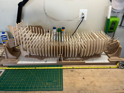

Vince, I have begun my journey with Amati's HMS Prince which I have been moving around since 1983 when I received it as a gift from my wife. I also purchased the Hobbyzone building board which has already proved itself valuable for alignment and safe storage. I have the keel cut and glued as well as all the cutouts on the 34 bulkheads... that took some time. I'm now ready for the next step as I was in search of the rest of the kit...fortunately I think I found everything in spite of it making about 20 moves during my Navy career. I was interested in one thing though... I saw on line another modeler actually made decks to go in the various cut outs and through the appropriate bulkheads. I saw that you put strips of wood along the various deck levels... then I got to thinking I was potentially missing those pieces. Can I surmise that they weren't part of the original kit and the other builder scratch built them... Thanks for the assist, Matt

Vince, I'm so jealous...mine is not that far along...16 grandkids has been a bit of a challenge... But I'm still working it....albeit slowly... also putting in the interior lower decks which is a challenge. Stern quarter galley(?) structures was actually pretty challenging...they are a complicated puzzle of parts...
