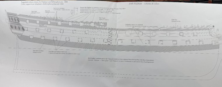

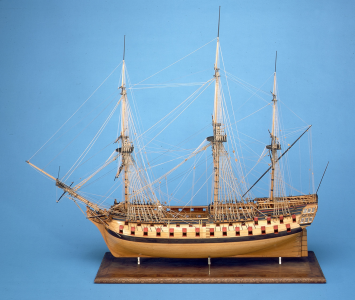

Just catching up and must say your model looks very well made ADoyon. There is something I had never seen on contemporary models or paintings so hope you don't mind a question. Does the kit show the black paint following the waterline as on your model instead of following the run of the wales and planking as was normally done?

Hi Allan, to answer your question about the black paint following the waterline…yes, the plans show black paint between the lower wale and the waterline for the HMS Vanguard build. The kit comes with the option to build three different versions of a 3rd rate 74-gun ship. Additional parts are included to build the HMS Bellerophon and the HMS Elephant. The paint scheme for the Bellerophon and the Elephant are different than for the Vanguard. The following drawing shows the paint scheme for the Vanguard. See lower right corner showing black paint between the lower wale and waterline.

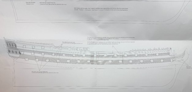

The following two drawings show the paint scheme for the Bellerophon and the Elephant, which follows the sweep of the wales. In the first drawing instructions show the colors applied to the shaded areas with a note to paint the main wale black. Unshaded areas are to be varnished. Although not specifically mentioned I would assume the area between the lower wale and the waterline is also varnished. The second drawing for the Bellerophon and the Elephant shows areas that can be painted yellow as an alternative to varnished sides.

Thanks Adoyon, your reply is very much appreciated.

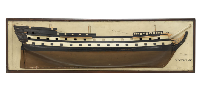

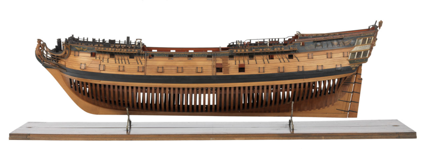

I did more research on the RMG website and found a couple contemporary models of 74s from 1804 and 1818 painted similar to the last photo in your reply. It seems to have come about near the time of the Nelson chequer pattern. Another example that very little was consistent across the fleet, especially from year to year.

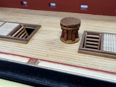

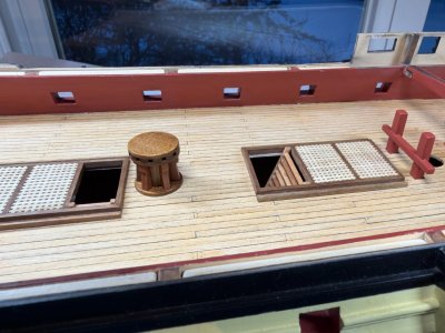

I’m now working on some of the fittings for the upper gun deck. Nothing is glued down yet. I need to place the cannons before glueing deck beams.

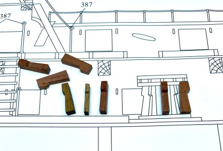

The kit comes with two capstans and 22 whelps. There is no mention of how many whelps to place around the capstan. Drawings in the kit’s plans show what is approximately six whelps. Also, in the book, Anatomy of the Ship HMS Bellona, it shows six whelps. However, the whelps provided are 1.5 mm thick and seem too thin to place six individually around the capstan. I tried gluing two together but didn’t like the glue seam showing since I planned on finishing with clear satin wipe-on poly. I made six whelps for each capstan from 3/32 in Swiss Pear wood. The following drawing shows the thickness of the kit’s whelps and the 3/32 in version I made.
Andre, your work is fantastic, thank you for sharing. I've just found this build log today and have spent a fabulous couple of hours reading and digesting this lovely ship build from 2020 until now. I'm now Googling Vanguard as you've inspired me. I love the detailed write ups, and your photos are great too. Glad you're back building and I will follow with interest!
Beautiful Andre. Your scratch whelps are stunning. Cheers Grant

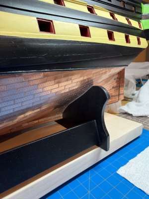

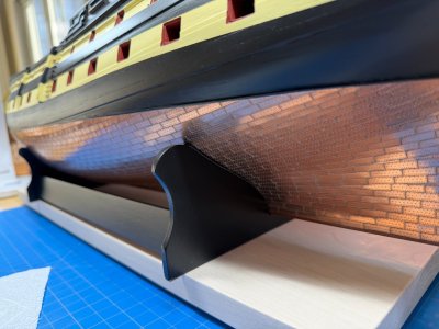

It took me a while to decide which yellow paint I should use on the hull of my ship. The yellow ochre that came with the Admiralty Paint Set seemed to be too dark. A little bit of research revealed that there were variations in the paint schemes used on British navy ships in the 18th century. I think it's likely that the yellow used was a shade known as “Bright Yellow”, which was commonly used on British naval ships during the late 18th century. With a little research, I learned that Bright Yellow was a light, vibrant yellow color that was created by mixing lead tin yellow with white lead or other white pigments.
I also learned that the HMS Victory was re-painted in 2017-2020 with its original colors during active service at the Battle of Trafalgar in 1805. The new yellow color on the Victory is much lighter than the previous orange-brown ochre that was on the ship for many years. I’m using Vallejo Ice Yellow on my Vanguard. To me it looks like it has about the same color value as the new color on the Victory.
The paintwork is truly perfect. That frogtape looks like working perfectly. Congrats!
The sizes varied depending on the size of the capstan. You might find the following helpful.
Thank you Allan for these drawings. These capstans look similar to those in Anatomy of the Ship HMS Bellona. I did notice the taper of the whelps in the radial direction but thought it would not be worth the effort to try and taper them. Drawings in the book are at 1/96 scale. I measured the thicker edge with dividers and digital calipers and came up with .0985" x 96 = approximately 9 1/2". This would be about 1/8" thick at 1/72 scale. I thought this would look too thick at the barrel, so, I decided to use 3/32" thick wood without tapering.
