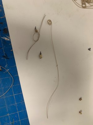

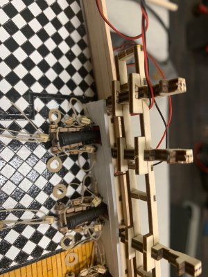

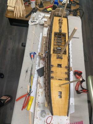

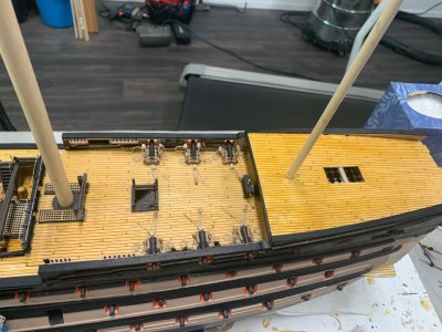

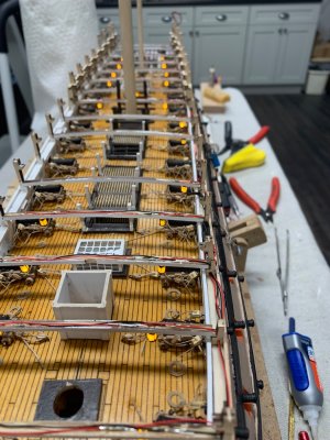

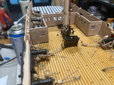

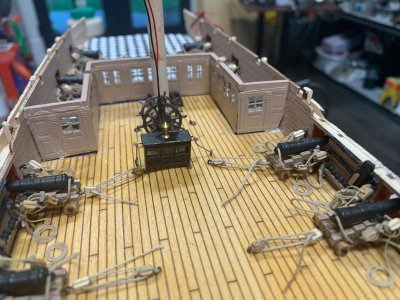

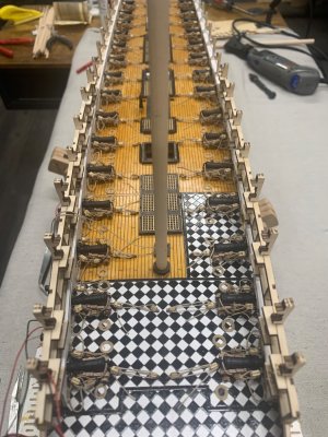

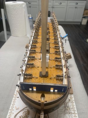

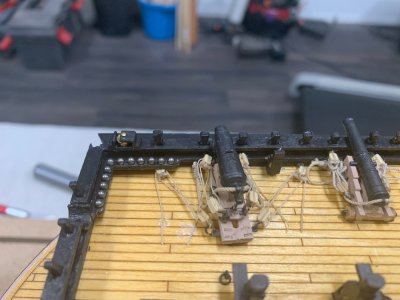

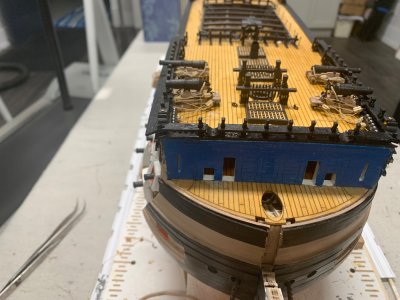

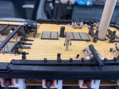

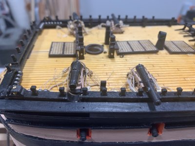

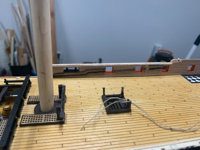

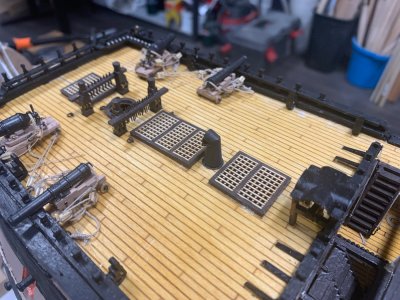

This kit calls for the cannon lines to be laid straight on the deck. As I got towards the upper deck and considering the last 44 canons I decided to make coils.
Here is the trick I figured out. If you make the coil with long enough extra rope the thread the other end through the double block,
The the single block and again through the double block. Finally thread the end through the loop I made at the top of the single block. This way after you attach the blocks to the hull and fasten the coils to the deck you can pull on the coil rope end to tighten things up and the pull tight the loop around the rope. A dab of glue and good to go.
As I got towards the upper deck and considering the last 44 canons ....The the single block and again through the double block. Finally thread the end through the loop I made at the top of the single block
I realize this is another mistake in the AL kit, but FWIW, IF accuracy is a priority for your build, guns on English ships under 32 pounders used 2 single blocks, not a double and a single on both the running out tackle and train tackle. Caruana did a lot of research into this and based his information on actual stores lists amongst other things. Page 386 of volume 2 of The History of English Sea Ordnance gives details.
Good tip Jim!
