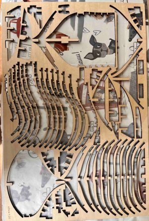

Hi Chris

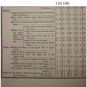

This may be of no concern to you but maybe interesting anyway. Is the sheet of wood in your post #3 plywood or is it solid? The reason I ask is that when the knee is tapered both downwards to match the breadth of the forward end of the keel and also towards the fore part of the knee going from 18 inches at the stem to less than 6 inches at the forward edge, plywood layers might show. I hope this is making sense :)
From folio XLVIII in David Steel's The Elements and Practice of Naval Architecture. The first two columns are for 110 gun and 100 gun ships.
Thanks Alan, helpful!
Plywood unfortunately. I'm planning to gently smooth the plywood edges, and then paint to hopefully cover up each plywood sandwich. I've almost got to a point in the build where it would make sense to do this before proceeding further.
