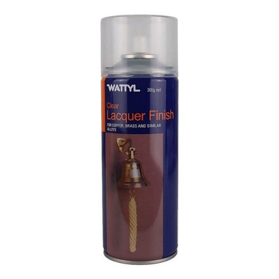

Just a quick update, just about done with the copper plates, almost 2 months later, a few left to do at the waterline that are being custom cut and then I will put the lack batten on, It is painfully obvious the difference in the sides now,, hopefully I can make it up canting the guns on the side that is too high. I am going to polish things up with brasso when done, and then put a .5mm X 2mm black batten around the waterline to seal the edge of the plates. I was wondering if anybody had any suggestions on product I could use to “paint on the plates” to seal them and protect them from oxidizing and turning green???
Hi traumadoc,
My go to for covering Brass or Copper with a clear is this product it works really well,
It had a trade name of Incralac may years ago and is a Lacquer paint that dries fast also very runny, not sure if it is available over in your neck of the woods though.
Cheers,
Stephen.

Hi traumadoc,
Cheers,
Stephen.
'Incralac', wonderful product for both interior and exterior coating. Didn't know it was still available.
