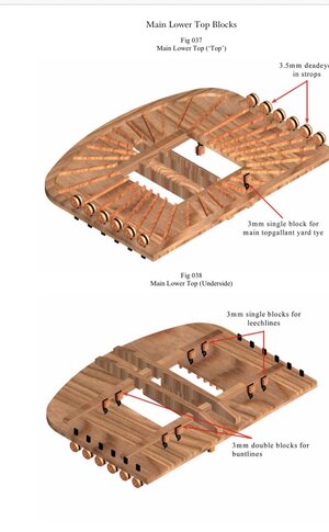

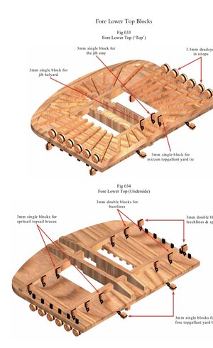

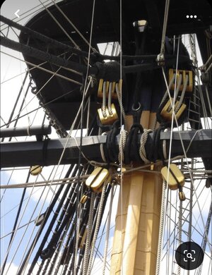

Here are the plans to place the blocks below the crows nest and the lines for which these blocks are used . The foremast and mainmast. I used 5mm blocks rather than the 3mm to fit my scale.
I borrowed these from Caldercraft ;). They are pretty accurate.

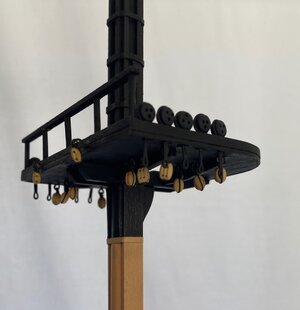

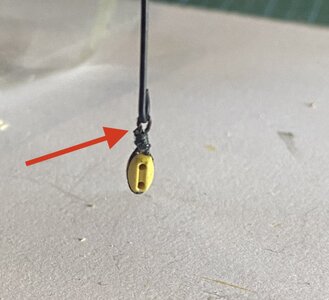

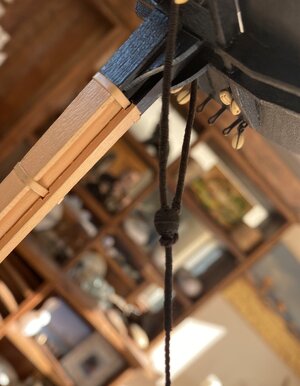

My process: The blocks are seized to the hooks. I still cannot get my “snip” perfect- arrow.

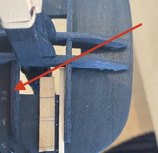

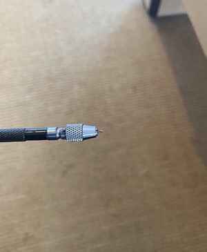

Made measurements on small piece of wood and a 1.8mm spacer to ensure the placement was correct. I drilled the initial hole incorrectly (arrow) before I decided to use this technique- seen in photo. To ensure the hole did not pierce the top of the crows nest I set my drill bit to 2mm. Used CA glue to hold the hooks in place- like so many parts of my build I hope this is strong enough.

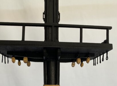

Photo of the main and then fore masts. Interesting to see how many more there are on the foremast. Clearly due to spritsails.
I feel your pain with this Grant. I believe you can get cutters just for that sort of thing, I saw it on a blog somewhere. The worst is when your snipper isn't sharp enough and only half cuts the line and leaves the remainder frayed. Super glue is usually my way out of those situations :)
Marks beers will be essential
Uh oh, I hope I haven't started a nasty trend here ROTF
Hello Mark. I do have AL rigging clippers- they work pretty well. I think I am more concerned about cutting the knot so don’t get them close enough and leave a little excess. I do finish with drop of CA. Re your trend....I think that has probably been well established by modelers around the worldBeer.

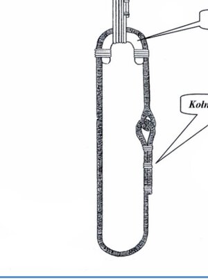

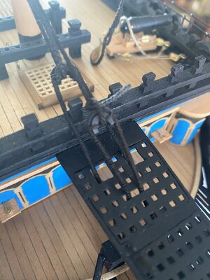

I decided to make the lower U blocks and rigging for the main stay. Many challenges where encounted as I tried to get it a little more authentic.

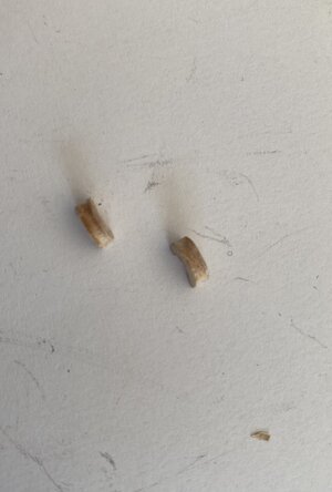

Making the blocks : I used a 6x1.5mm x1mm birch wood and drill a 3mm hole in center- cut it in half. Then shaped with needle files.

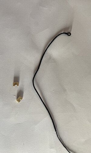

The 1mm rope was seized with 0.2mm thread and a loop at one end was lashed.

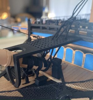

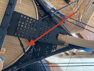

My Marine walk created a problem as I made this per instructions (with look through mod) however it actually needs some squareS cut in it. I was not going to redo this. The little squares where not big enough and created a symmetrical issue with the lines. Did what I could.
Lashed the second loop Around the bowsprit(had to do on model- was not the best).
The U blocks I made where lashed to the seized rope.

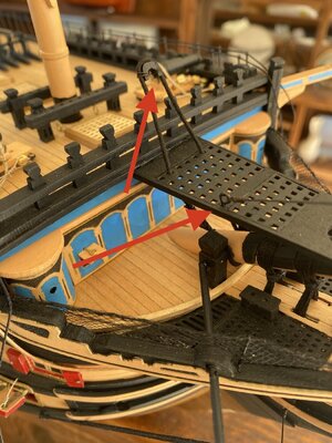

I added the Rope rail from the Marine walk to bowsprit cap. (Second arrow)

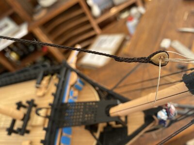

I attempted my first mouse, more like a scruffy ratROTF. This is for the forestay. A 3mm dowel was cut, shaped and center drilled for the stay to pass through. The stay and mouse were seized.
I fitted the heart deadeye (A modified AL product). Loosely tied to the U blocks I made many moons earlier). Nothing tied off as I clearly have loads to do prior fitting the masts.D755F9B7-4831-40B7-8CA3-7E8D40CCCF8F.jpeg

THE BUTCHER OF THE MARINE WALK.....

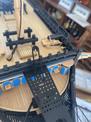

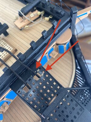

thank you @Heinrich , @dockattner @Daniel20. I couldn’t deal with the lack of “symmetry” with the lines of the lower block ropes through the Marine walk. I knew this was a fragile “ modification” I made earlier so was hesitant to take off and make the square holes. But gave it a go. I did break it, but only slightly (arrow) and cut in wrong place Speechless.The rectangle for the Main preventer stay was also made. Managed to repair and the reinsertion went better than expected although not a good as initially made.
So much better. Just have to finish off the paint and apply thin Matt poly.
Much better indeed - visually and psychologically for the builder!
