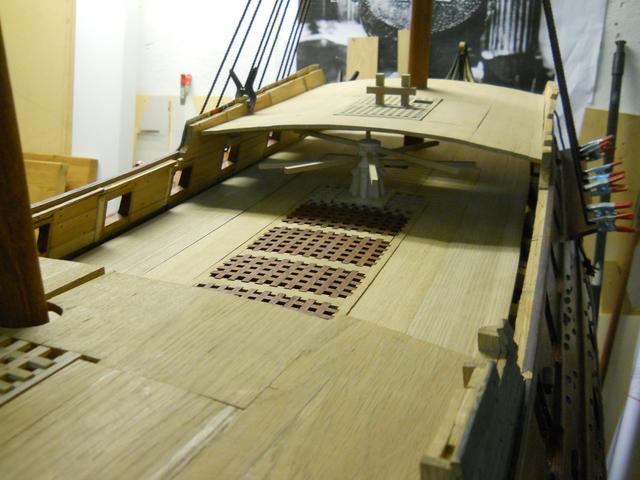

Anyway, here's the promised update! The upper gundeck planking is now almost complete. Here's a view of the main cabin with completed deck planks and additional work done to the cupboards:

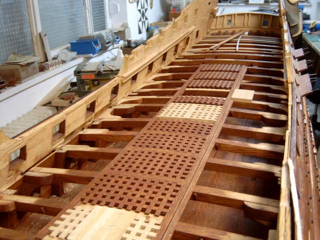

This picture was taken while I was halfway through the planking. Four sections of the deck can be removed to view the interior. Here these sections are in place:
And here the sections removed:

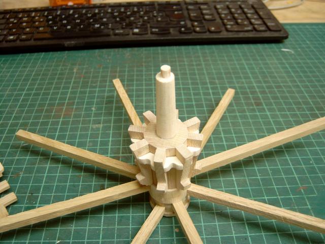

I also built the "small" capstan which is located underneath the forecastle deck. Once it was done I noticed it isn't that small at all.

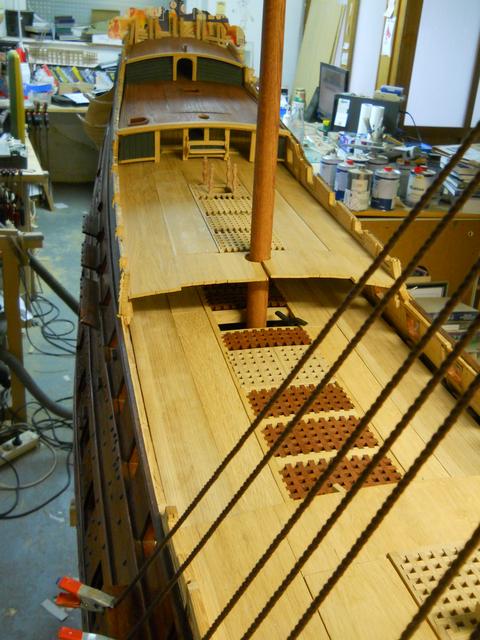

The nearly completed upper gun-deck:

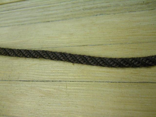

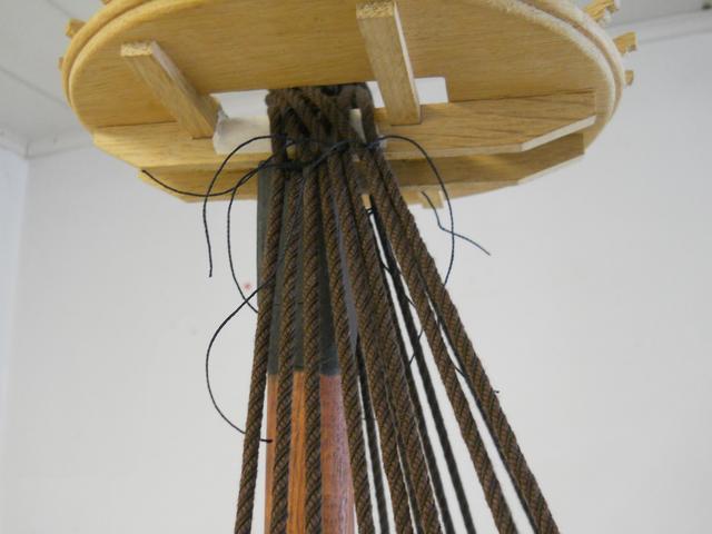

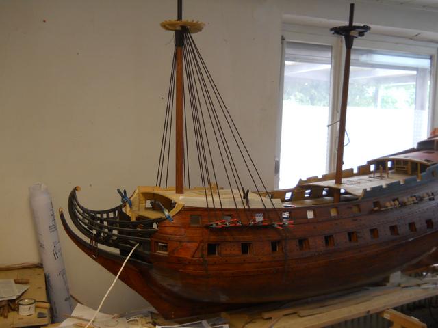

I was getting a bit tired of the mess tarred shrouds create, so I tried out shrouds with pre-coloured dark brown lines:
Far better! I think I'm going to use these:

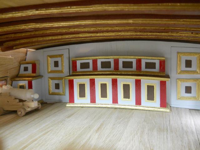

All main gundeck knees and riders are now in place. Here's the completed Konstapelkammer which I did today:
And here for comparison a view of the historic model:

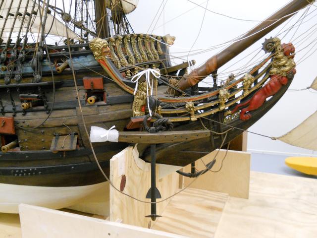

High time for the next update! Two weeks ago I was fortunate enough to examine the "Gent Model" with a few friends. This is also a contemporary model of the Dutch Two-Decker which is slightly larger than the Hohenzollern model, maybe in 1:18th scale.
The model has been seriously messed about with in the past centuries. The rigging isn't original and also parts of the masts aren't. Until about two decades ago the model had white bands painted on the hull which were common after Nelson's days. The Gent Model also dates from the second half of the 17th century, my guess is that it is slightly younger than the Hohenzollernmodel but some scholars disagree.
I believe that the model wasn't built by the same shop that built the HZM as it isn't as well built and not as detailed. There are also very noticable differences in "handwriting"
The model isn't on public Display. It is in storage of the STAM-Museum in Gent Belgium and the Museum staff were very helpful and allowed us to handle the model and take measurements.

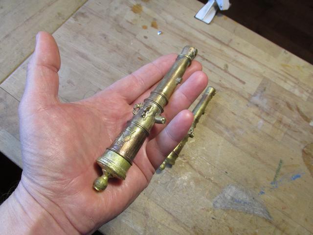

I wasn't really very happy with the bronze cannon that were cast in a local foundry so I contacted our very own Alexey Baranov from Ukrania to see if he might cast cannon for me in the lost wax method. Indeed he is now casting 26 fourteen-pounder bronze cannons for me. Here's what they look like, look at the Detail! This quality can only be acchieved by a modelmaker for a modelmaker!
I'm certain you don't mind me posting one of your Pictures here, Alexey! :)

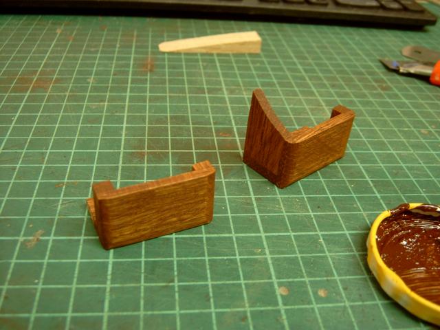

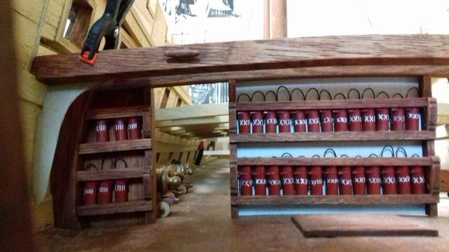

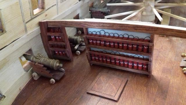

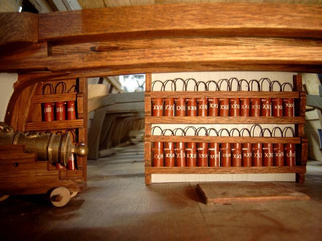

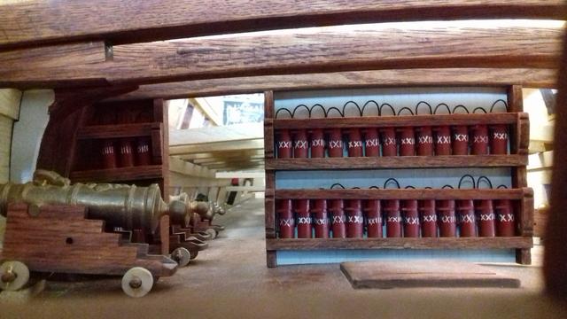

In the past week I continued building the cartridge shelves for the Kontapelkammer. A template was cut out from cardboard for one of the rear walls. Small snippets of cardboard were used to follow the contours of the inside hull wall.
Here is the real wall made from oak:
Here the port-side shelf is finished including the "Steunder"

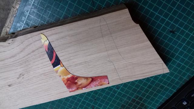

The same template that was used to form the rear wall was used for the standing knees:
Several attempts were needed before I was happy with the shape of the knee. Here the knee is drawen onto oak-wood:
and here the fully shaped item:
I think I can live with this:

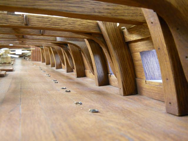

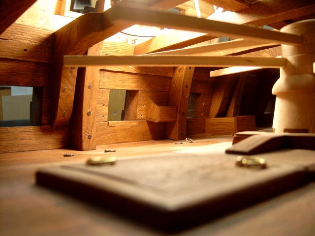

Ringbolts have been added to the deck on both sides:
In the meantime I have received the cannons from Alexey, they are superb! Thanks for your help, Alexey! :)
All knees are now completed and firmy fixed to the hull:
The shot-bins are being added too:
Note the sand-pit to the far right:

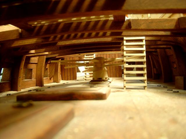

The two ladders leading from the upper deck down to the maindeck have been built:

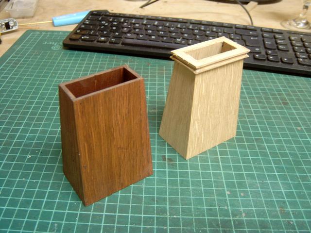

I built a new stack for the galley-stove
And attached it to the deck

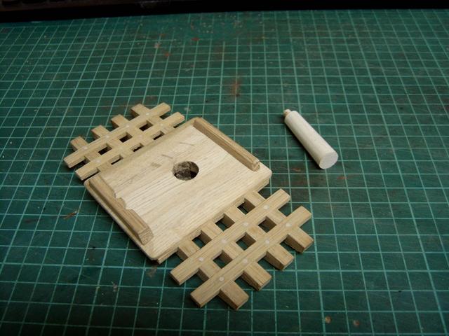

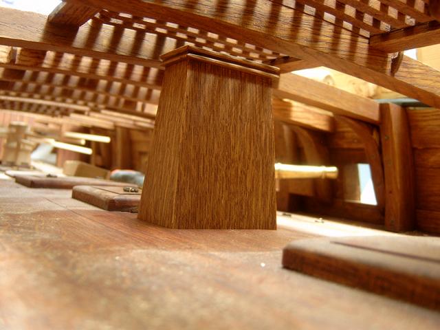

And here the trunk of the upper deck capstan:

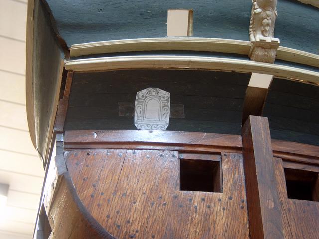

My Word! the last update was before Christmas! Sorry for taking so Long, quite a bit has happened in the meantime. First and foremost the sculptor has a new sculpture under preparation. It has been sent to me to fit it to the hull, here it is at the top of the taffrel:
That was back in December and the carving is still here being filed and fitted before it'll be sent back for fine-carving.

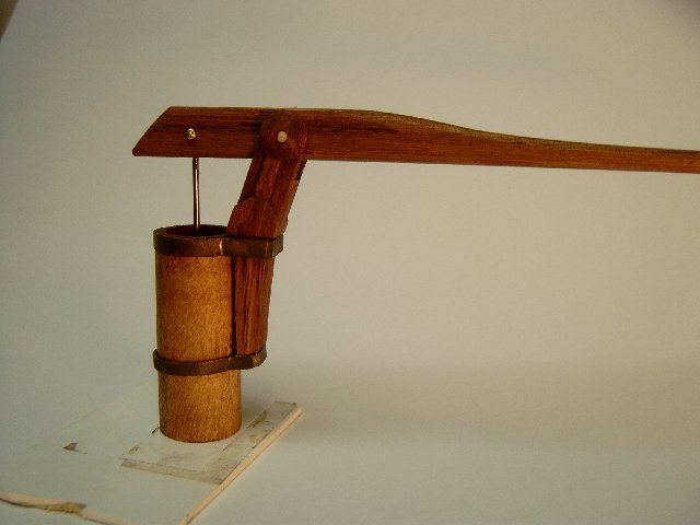

Work on the maindeck is also progressing well, here's one of the bilge pumps under construction:

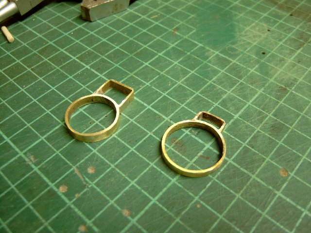

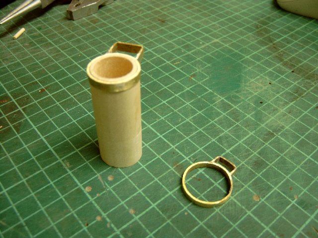

I also took up the challenge of producing the chains for the deadeyes. They are formed from 2.5mm brass rod. Bending them is by no means easy, I have to heat the rod first with a blow-lamp.
And yes, you might have guessed, it took me several attempts to get them right. I am now finally pleased with the mainmast chains on the port side:
